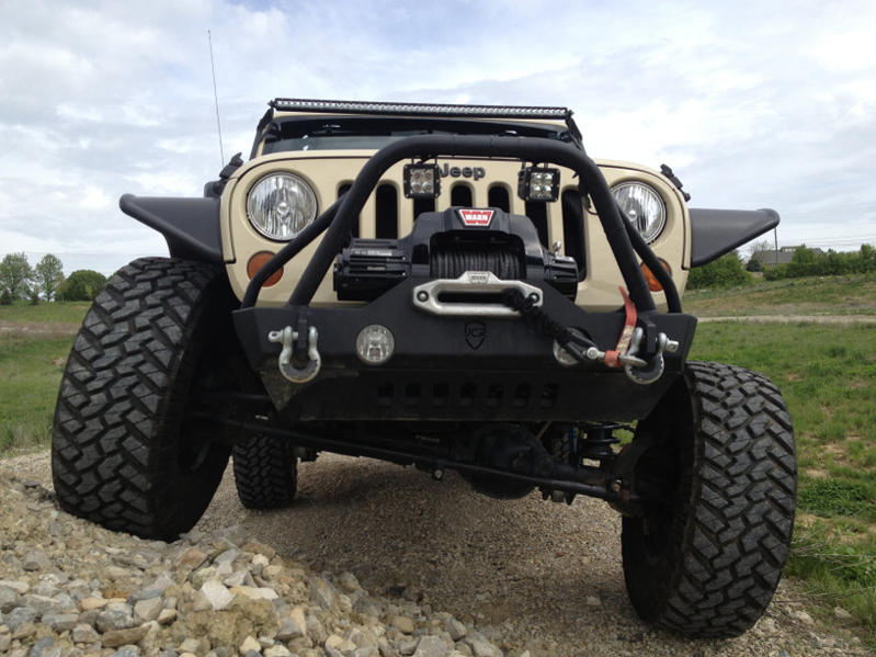

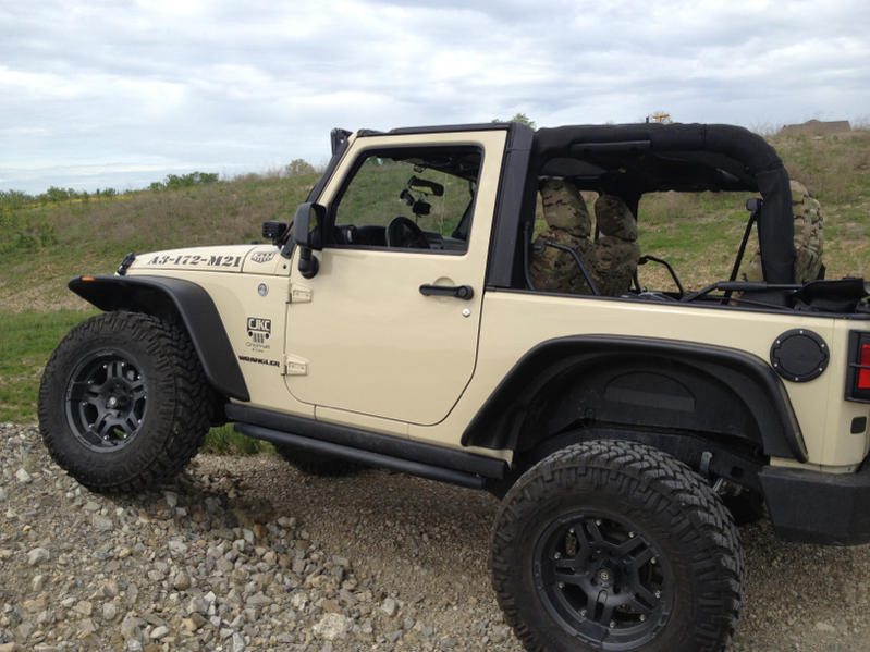

The on road / off road handling of the AEV 2.5 Dual Sport XT is very good and worth every penny. People like to hate on AEV because of the drop brackets. I agree I was not a fan on that idea either so I went with rock krawler high clearance adjustable lower control arms. Problem solved. I also used JKS quicker discos instead of the sway bar link brackets.
Most people that hate AEV have never driven an AEV lifted jeep. I was one of those people. Body roll and nose dive are gone! The cornering and handling of the jeep is amazing. The reason I choose AEV was because I have a 2 door JK automatic and they were the only big company that geared lifts specifically for a 2 door and would give me an accurate lift hight. I did not want to go above three inches. I got exactly 3 inches of lift out of this kit.
