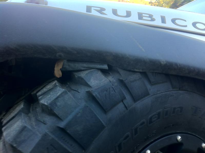

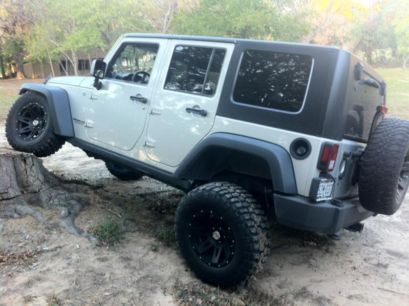

Springs always work better than spacers. You will need to trim fenders or increase bumpstops if you disconect. I rub pretty bad disconnected and crossed up when off-road.

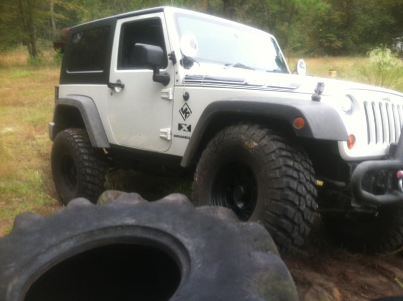

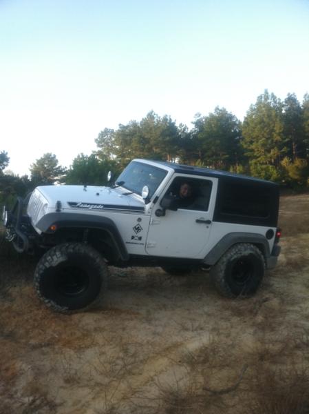

Coils will give you more flex, but your drive shaft will be safer with spacers. I don't rub at all with 35s and 2.5 tf coils
