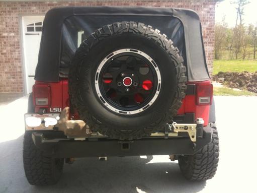

I have a Fab Fours lifestyle front bumper with stinger and a Rock Hard 4X4 rear bumper with swing out tire carrier and love them both.
ID:	138486   Click image for larger version
Old Mar 16, 2011 | 07:00 PM
srt8ftw's Avatar
Posts: 264
From: mclean va
those look really nice but i think im looking for sumthing smaller as seen on HM jeep, any other suggestions on anything???
