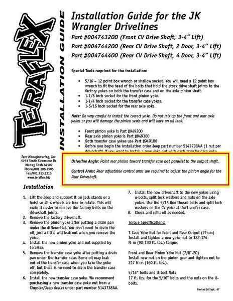

Go to the Tom Wood's DS site. It shows the correct way to set up an aftermarket DS and the angle of your pinion.
The adjustable control arms are necessary to move the pinion to the correct location.

The factory drives shafts can't handle the extreme angles created by the 4" lift.
There is an explaination of how/why to adjust the rear control arms when installing the lift with the new drive shaft.
I highlighted that section in the attached instructions.
