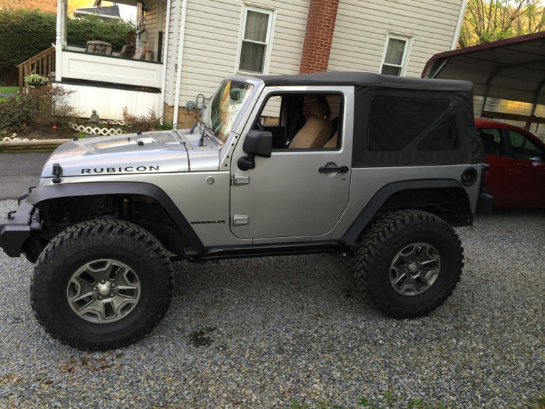

Old May 15, 2014 | 02:09 PM
PAGary's Avatar
Posts: 59
From: Clearfield, PA
Went with the metalcloak 2.5" lift and it rides great!
