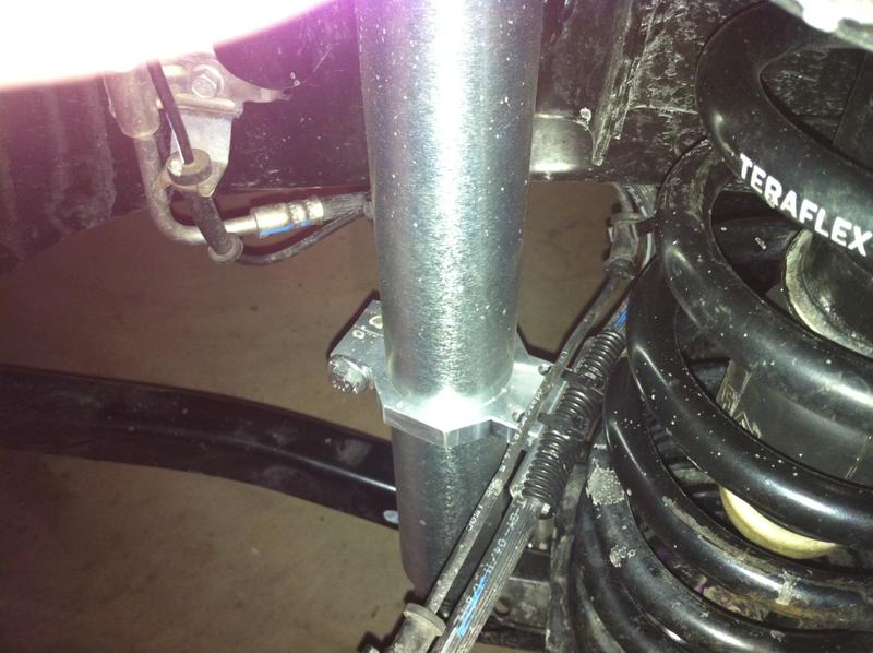

Default 2012 Front Brake Lines
I just installed a 2.5 Teraflex lift and did not need any extended brake lines. The rear lines worked great with the relocation bracket however the front lines are more challenging. I had to make a couple of custom brackets from aluminum that clamp to the shock body and hold the brake line. The hard part was removing the bracket that held the brake line to the lower spring perch. I used a dremel tool to VERY CAREFULLy cut the bracket from the line. I then used zip ties to hold the line to the new bracket. The front lines are plenty long enough once you can relocate them up a bit.
