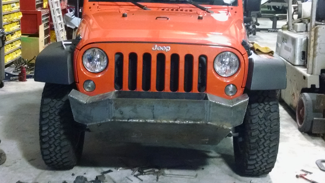

Looking for options on my bumper i m building. Still no done, gonna add factory fogs in the skid plate, and a hoop to protect the grill, and d ring mounts. Any other thoughts are welcomed.

Old Jun 21, 2015 | 07:52 PM
rj'sjeep's Avatar
Joined: Mar 2010
Posts: 517
From: Encinitas, CA
Default lookas very beefy
Is it heavy
Old Jun 21, 2015 | 08:01 PM
outlaw26's Avatar
Posts: 86
From: louisiana
Never weighed it but I would guess about 50-60lbs.
Old Jun 21, 2015 | 09:51 PM
GoldenRubi's Avatar
Joined: Mar 2015
Posts: 193
From: Santa Maria, CA
How far does it stick out and how far does that skid plate come down? Don't mean to be a negative Nancy, but it seems like you'd be killing your approach angle with that bumper. Do you have any pics of it taken from the side?
Old Jun 21, 2015 | 09:55 PM
outlaw26's Avatar
Posts: 86
From: louisiana
Sticks out 9 inches, same as stock, but is raised up higher. skid angles down and attaches to frame just below sway bar disco.

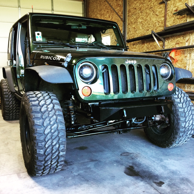

I went with the minimalist approach.
Old Jun 22, 2015 | 07:48 AM
D_engel's Avatar
Posts: 2,539
From: Tempe AZ
post up a few more pictures if you can. A profile shot and a head on shot, but from down low so we can get an idea of heights.
Old Jun 22, 2015 | 08:10 AM
outlaw26's Avatar
Posts: 86
From: louisiana
I will later today, in trying to decide on factoy fogs or 24" led bar, or 2 small led square lights in the skid.
Old Jun 22, 2015 | 08:13 AM
JE8154's Avatar
Posts: 2,256
From: Madison, New Jersey
Thing is massive. Looks like one of those Flog bumpers

Going to start mine in the next few weeks here and planning on doing something like this but with the factory fogs and a hitch receiver to accept a hitch mounted winch. Looks good man.
