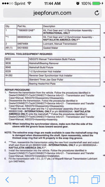

This should help

Awesome. Any way I can get that sent larger ? email or link? Having trouble making out all the words.
