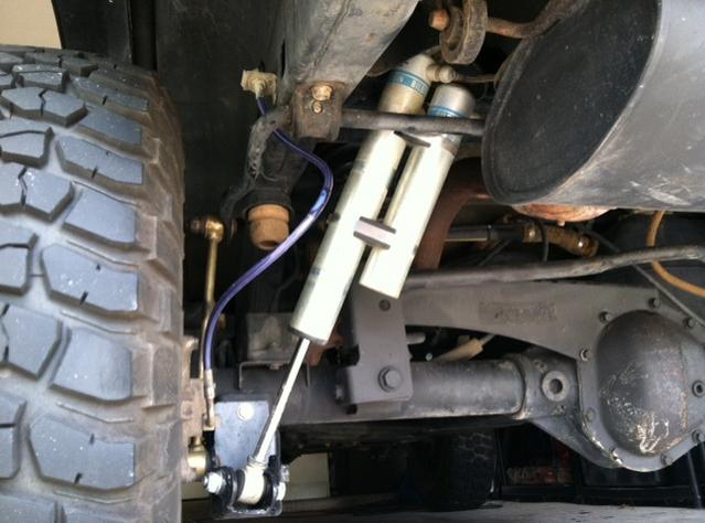

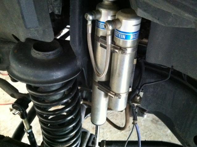

Had these 4" plush coils as my previous setup, it's more like a 3" - 3.5" with full bumpers and hardtop, tire carrier w/ spare. Had the front lower adjustable control arms to adjust my camber and also you need an aftermarket front driveshaft for the 4 door unlimited. A draglink flip and trackbar relocation bracket should be used for this kit as well. I ran these with bilstein 5160's and it flexed / rode pretty smooth on the highway. If you have a really heavy front end you will need 1" spacers up front cause it will sag a bit. Someone in this forum will be selling this set soon as he will also go coilovers.
