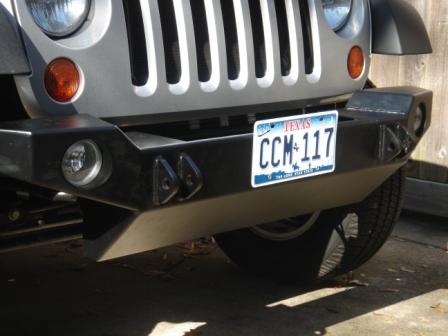

I put an LOD Offroad bumper. The factory fogs fit, but you have to drill out the mounting holes a little bit and add about 10 inches of wire. THey also added two extra clevis tabs so I can use my towbar.
