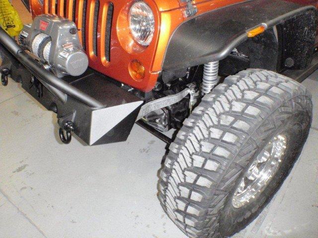

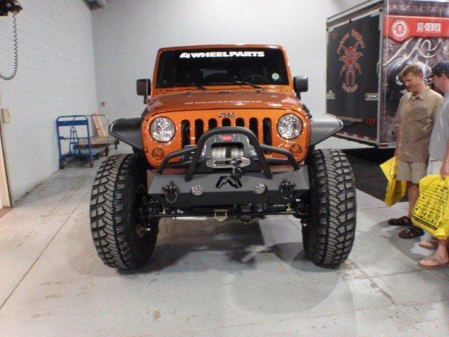

You know, i rarely see any one talk about the Fab Fours Bumbers, I think they look sick. They make a full width one too.
I think sag wouldn't be an issue, unless you stuck a 100lbs wench on the front.
