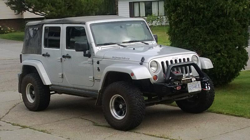

If most of your build is cosmetic I have a suggestion. When I bought my 2 dr I was told by the sales manager (who has a lifted wrangler himself and was a wealth of knowledge) that in stock form you can fit a 33 inch tire. With that being said to fit a 35 in tire you only need another inch of clearance. You can pick up a 1.25 inch body lift for $100. Use the money intended for the lift on gears. For a daily driver your driveline stays stock and you get your look. Do your research on lifts while saving your pennies and if you still want that lift ( or start off roading more) than buy your suspension lift. I run 35 inch KM2's on a 2 inch suspension lift by Old Man Emu.
