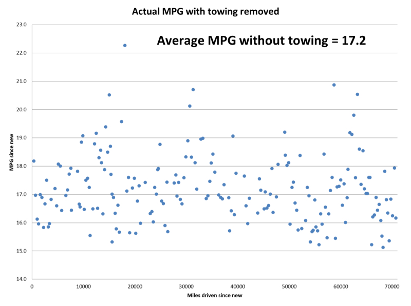

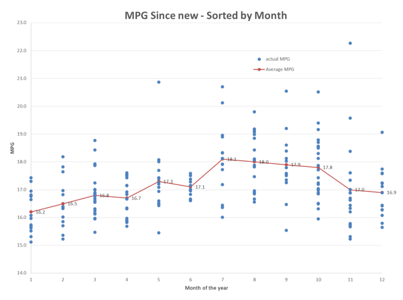

Here is the MPG you can expect from a basically stock JKU. Anyone claiming repeatable 22mpg is lying or ill-informed. Maybe they never corrected speedo. I check every single tank using hand calculations. Here is the data.
ID:	644180   Click image for larger version
ID:	644181   Click image for larger version
