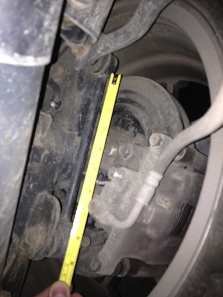

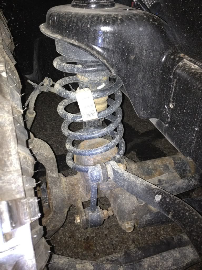

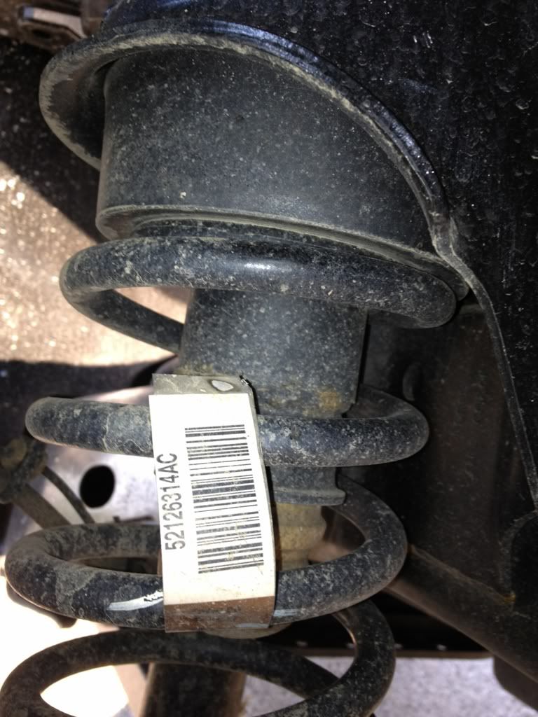

Just bought a 2dr 2010 sahara, was looking at jeep and realized it has 2" spacers with no badging on them.
My ? Is what lift is this, and am I missing some important parts?
Correct me if I'm wrong but there is no extended bump stops, factory sway bar links, and factory shocks, and no front coil isolators.

Looks like a 2.5" front spacer and a1"rear spacer. Basically a what the lift companies call a budget boost or leveling kit.
The front spacers look like the tera flex spacers I had on the front of my jeep. I ran front spacers and nothing else for 2 years and went places I shouldn't have with stock mudders and never had a problem.
You should be fine.

Yes, as the others above me said. It's just a budget boost. No big deal about missing the bumpstops. If you want them you can buy another budget boost online for a little over $100 and use the bumpstops in it. You don't need them though.
I had issues making long right turns (like an on-ramp) after my budget boose because the ESP would kick in and kill the power and apply the brakes because it thought it was skidding. I ordered a Procal Chip and installed it. After that it ran perfect! Just saying incase you experience the same thing.

^----- X2 for sure. As a starting point, you might look at Bilstein or OME (Old Man Emu). In case it's not clear, the previous owner would have installed the leveling kit because a stock JK has a pretty significant front end rake to it.
