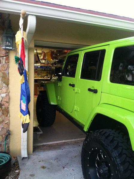

4" w/ 35's...no Problem.
Stuffed mine in with room to spare = 6" Long Arm on 37's

I have a lower than normal garage. I think I have 77" of clearance.
My friend has a 2007 JKU, with a EVO 4" Enforcer Lift, Hankook 35x12.5x17s and clears my garage by a little under 2 inches.
In addition to this lift, he has a evo 1/4 pounder front bumper with warn 8000lb winch, and a purejeep rear with tire carrier.
