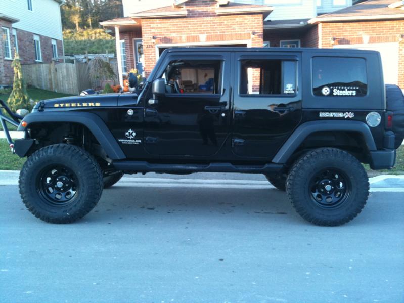

Just for your information..... the Teraflex 3" with the flex arms lift kit and if you want to level out the front(get rid of the rake) will get you over 4" of lift...., with 35's you won't need to chop your fenders/flares cause there's plenty of room, too much almost. I have the 3" lift with 35's and love the chopped fender/flare look but haven't done it cause I'd have way too much space... I'll wait til I move up to even larger tires.
