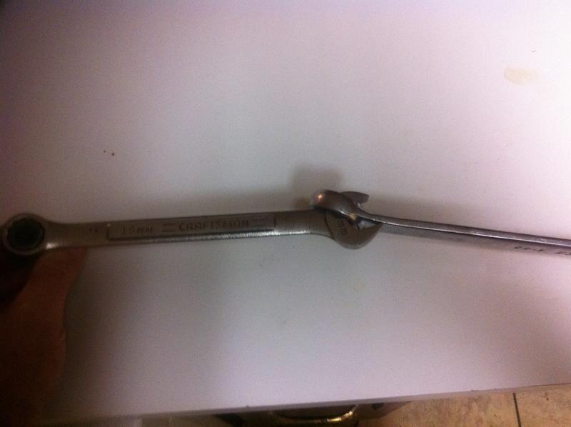

Those bolts aren't siezed they have loctite on them. If you don't have a 1/2" drive breaker bar of sufficient length slip a piece of pipe over it. 18mm socket (six point preferably) by the way. If all you have is combination wrenches you can hook the box end of another wrench over the open end of your 18mm and gain some leverage that way. The seat belt reciever is held on with torx head bolt. Looks like T45 but haven't tried. Probably cheaper to buy as a set anyway.
