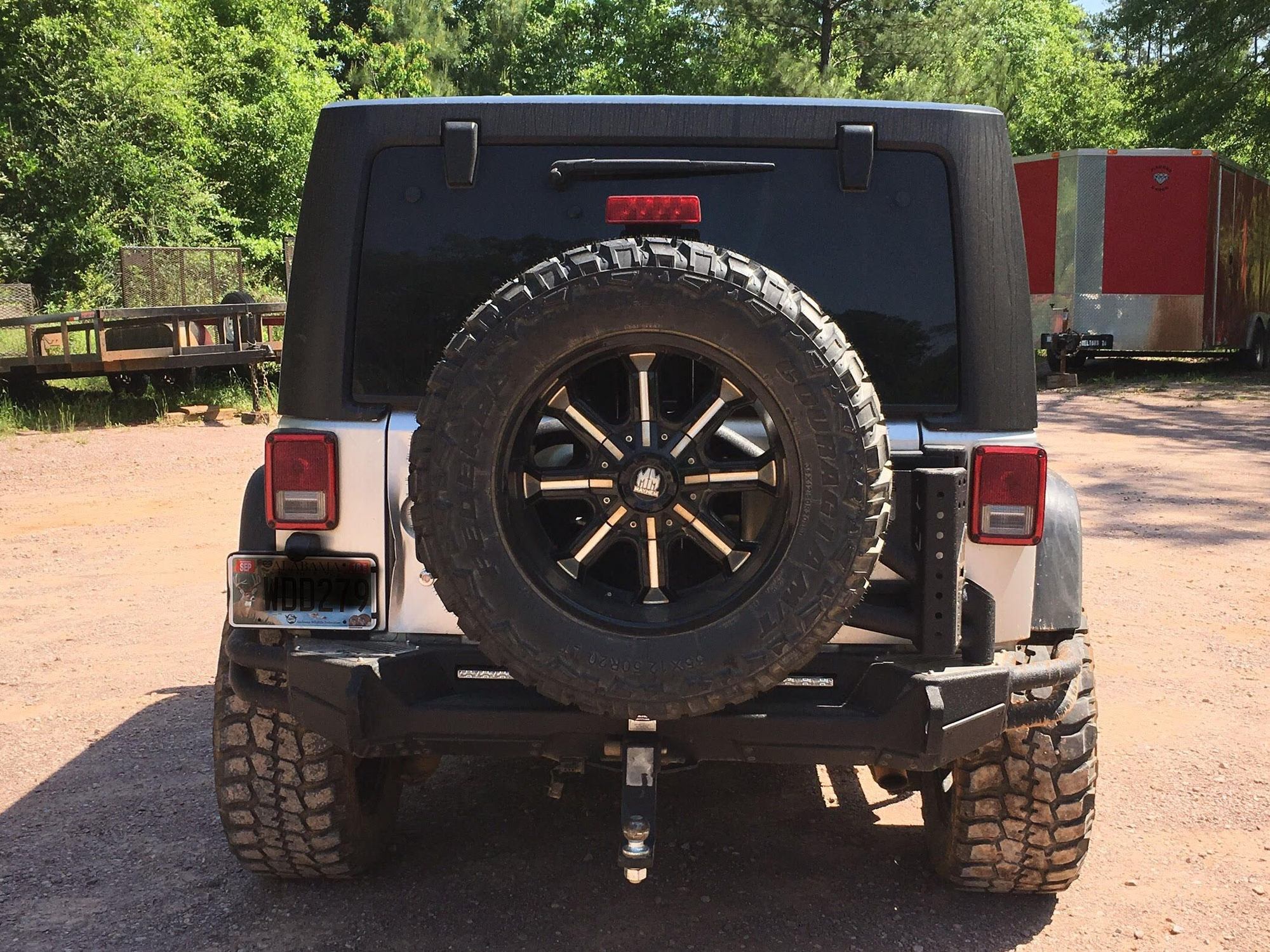

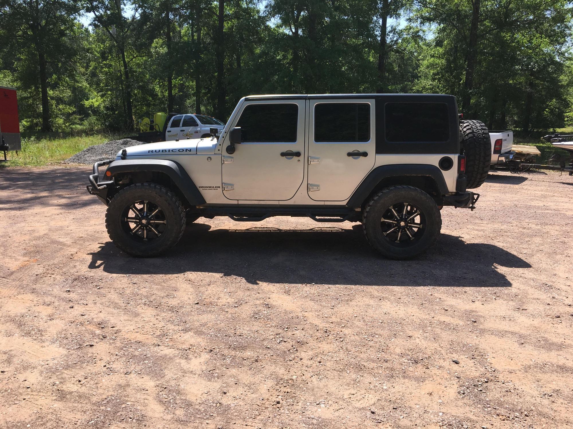

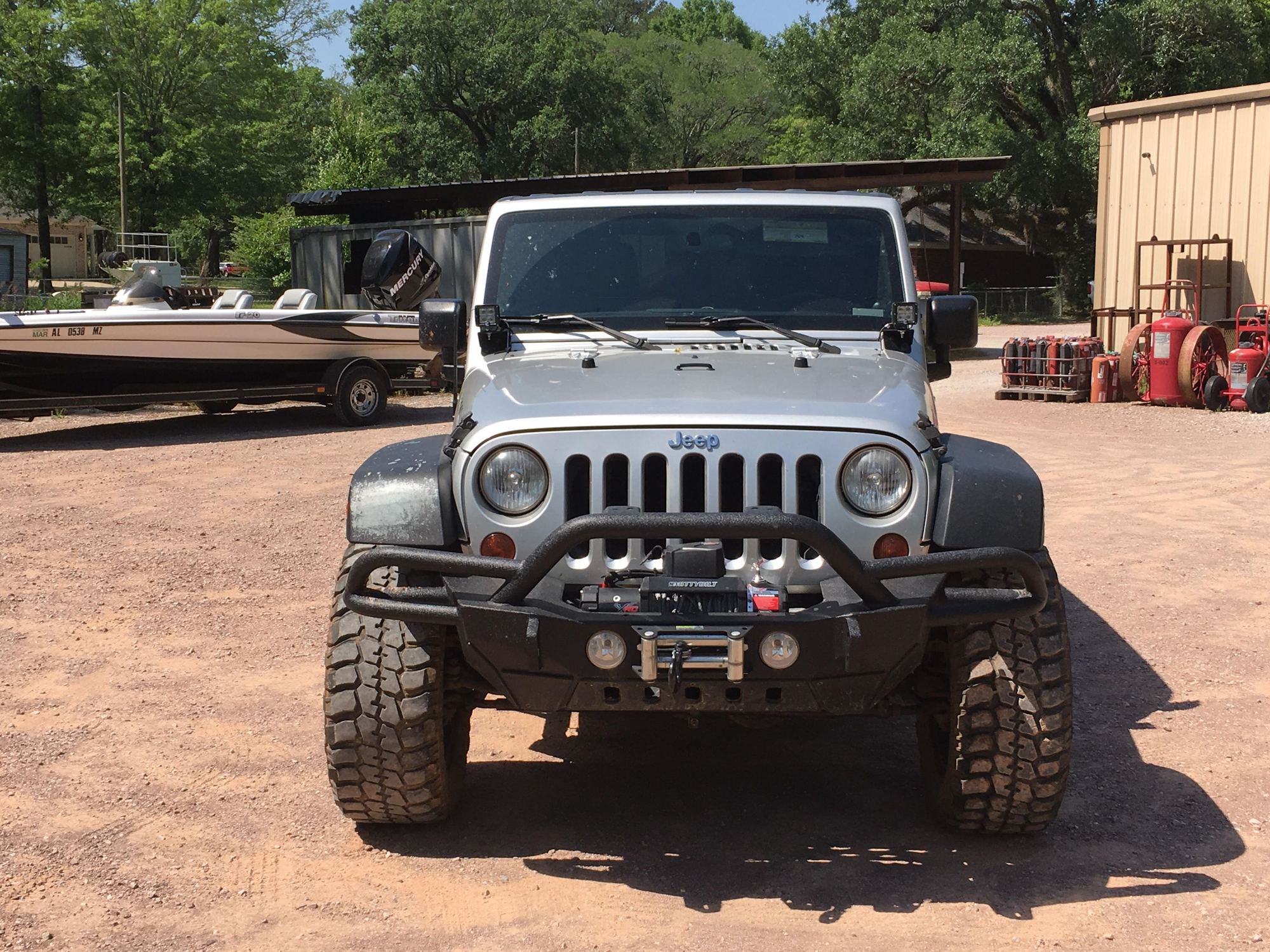

PLEASE IGNORE THE FENDER FLARES AND TAILGATE THEIR BEING REPLACED MONDAY!
