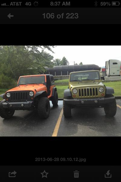

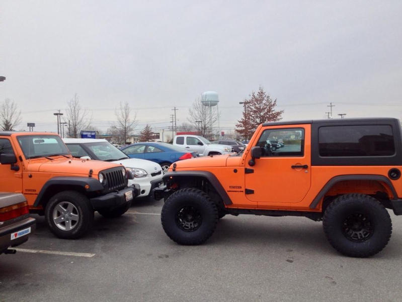

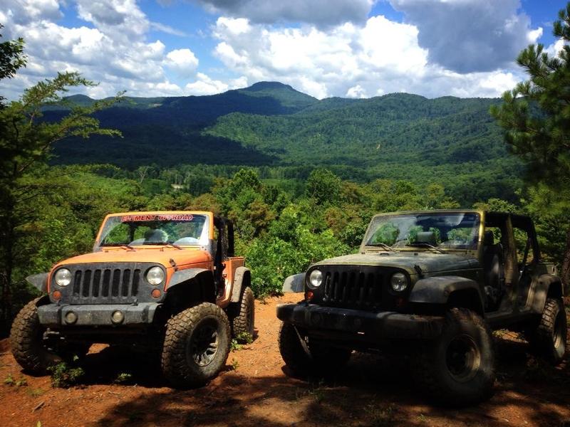

4.10's refer to the gears. You can go on Jeep.com and register under owners section and get your build sheet which will tell you what you have. Do you have a 2 door or 4 door? If you are fairly new to wheeling, a Rubicon on 35's is capable enough to do way more than you can probably imagine or are willing to do with your Jeep Here are some pics of my 2 door and my friends 4 door.
Mine has 2.5" lift and his has 3", both on 35x12.5x15 KM2's. Also a pic of mine vs a stock jeep to show the difference. My personal opinion, if you want your tires to look as big as possible, sell the 17" rockstars and pick up some 15 or 16" wheels (some 15's don’t fit the JK's tho). Also, tires for 15's are significantly cheaper and will give you more sidewall, thus more tire to look at if that makes sense. Certainly nothing wrong with 17's tho, as that is propably the most popular wheel size for JK's.

I have a 2 door. Both of those are amazing! Is yours the orange one? I've also been looking for that grill, either doing it myself or buying it. How did you do get it? I'll definitely take the 15s into consideration even though I love the rockstars.

Yup mine is the orange one. 15's are nice, but keep in mind, some aftermarket parts such as tie rods and big brake kits won't work with the 15's. Go browse around at tire prices for both and see what you think. Another option to save some cash is to keep the 17's and go with Treadwright Guard Dogs. Search around, plenty of info on them but long story short (sorry I'm at work) they are retreads but lots of great reviews on them. You would need wheel spacers tho with those to accommodate the wider wheel. They run around $160 for 315/70/17 (aka 35").
It's hard to go cheap with 37's without paying for it in the long run. But you can build up to 35's without spending thousands. My whole build is under $3000 and that includes a rubicon transfercase swap.
As for the grill I just took it off and used Duplicolor spray can bed liner. Pretty easy to do. If i would do it again tho, I'd use the Rustoluem bedliner instead. Used that on my hinges and i like the finish better. Both have held up great tho.
