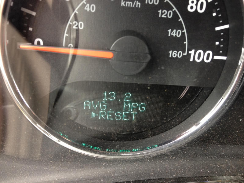

I live in Texas. Have a similar drive too. And have a house in Pagosa Springs. So I do the "Colorado thing" too. I have 3.23 gears and 35x12.50-18's. Works fine for me. Haha. Could it better? Of course. I will eventually re gear to 4:56 or something, but, for now it works. I pull a 2000 lb boat daily. No problems there either. So, in reality, any size will work. You will lose some gas mileage for sure. And lose some useable power, really for sure. Lol. But it can work. I have a 12 with a 3.6 auto. Gas mileage REALLY SUCKS!!!! Click image for larger version
