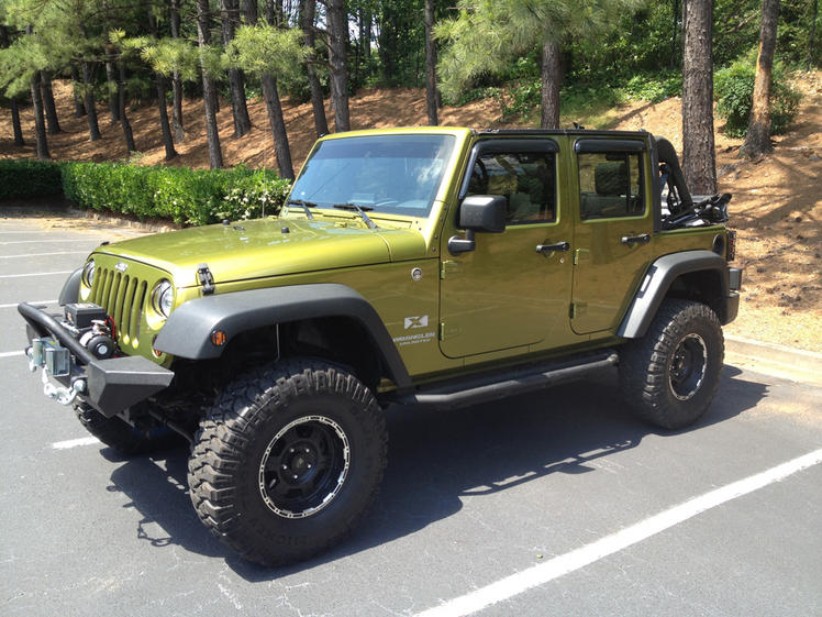

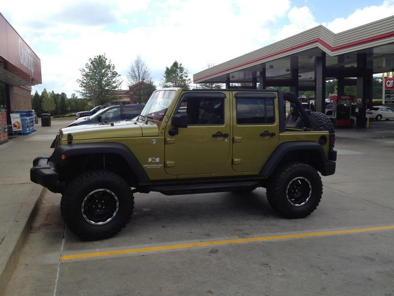

Here is my current Jeep. I like the wheels ok that it came with but would rather have something else. I only put 5k-8k miles on it a year, so whatever I do I will have a long time. So this decision will be with me for probably 5 years (or til I get something else). As much as the hardcore Jeep guys fight it, it seems larger wheels are taking over the market. Like I said, my truck might see a dirt road and that is about it, so I am not worried about scratching the wheels.
I really want 37s (look better and bring down my rpms) and don't mind the initial extra cost. It sounds like the longer term cost (breaking/bending things) will keep me from it. I was hoping if she was a pavement queen, the larger tires wouldn't really strain the components as much as I have been reading it can...

If you really do just use it on the road then you should be able to get away with some lighter all terrain 37's without any serious issues.
