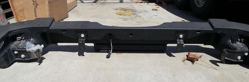

Ok, so I took a picture of a 2013 Unlimited Sahara bumper for you.
If you wanted to drop the bumper slightly to fit the 35", all you'd need to do is redrill the center brackets above the existing holes, and drill a slot in the side brackets.

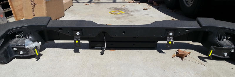

Matter of fact, I've done it for you!
Just bolt her up and.... Wait, virtual reality is not real.
Ok, just follow my yellow diagram then!
(you could also get some metal and make your own brackets, if you were nervous about messing with yours)
