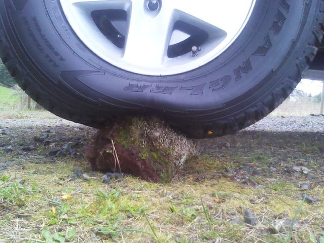

'Can't speak to those tires specifically, but I recently switched to GY Adventure's in 285/70-17 (Load Range E), which are available in your size as well. Sever Snow Rated (Mountain Snowflake branded). Had the same concerns as you. They ride just as good as the previous Load Range C tires did (34 PSI), and they appear squish out well when aired down (pic below). To me, tires are complicated, lot more to how they ride and flex than the load range.
Edit: BTW, stock wheels, no wheel spacers, stock bump-stops (with 2" lift) and no-rub at full articulation with washers on steering stop. Probably would be fine with no lift unless it was compressing the bump-stop extremely hard.
