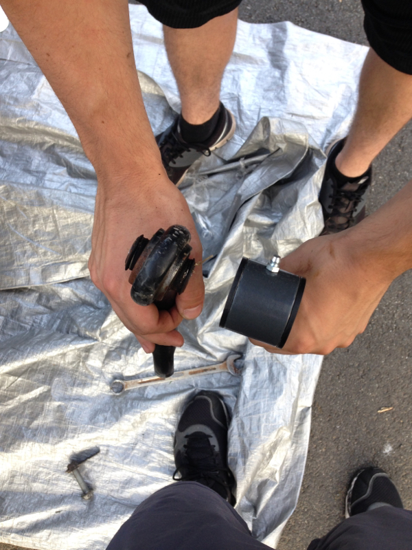

I bent mine after I went to 37s. If you don't have that large of tires such as 33s and down a stock track bar will do just fine.
