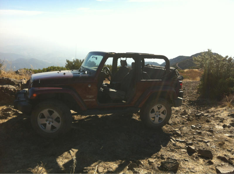

Originally Posted by hamrickac
I'm running 265/70r17 which is pretty much the same size and it does seem really small, next tires I get will be 285/70 and I'm hoping it fills the well a little better. (I will either have to have wheel spacers or change rims first though)
Could you post a pic please? If they look about the same size as my current tires I will be happy. If they look a lot smaller I am gonna be bummed and have to look for a different alternative.
This is what my tire / wheel combo looks like right now.

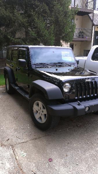

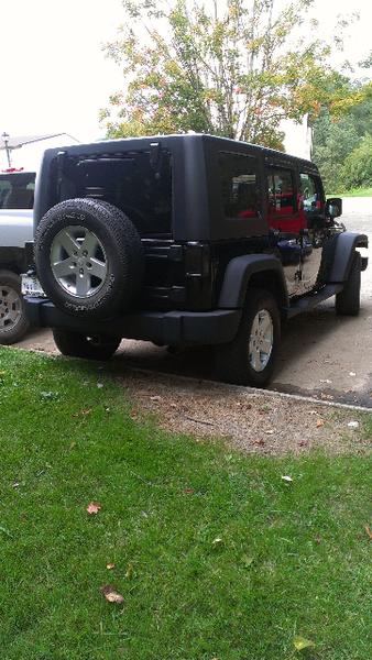

Hope this helps

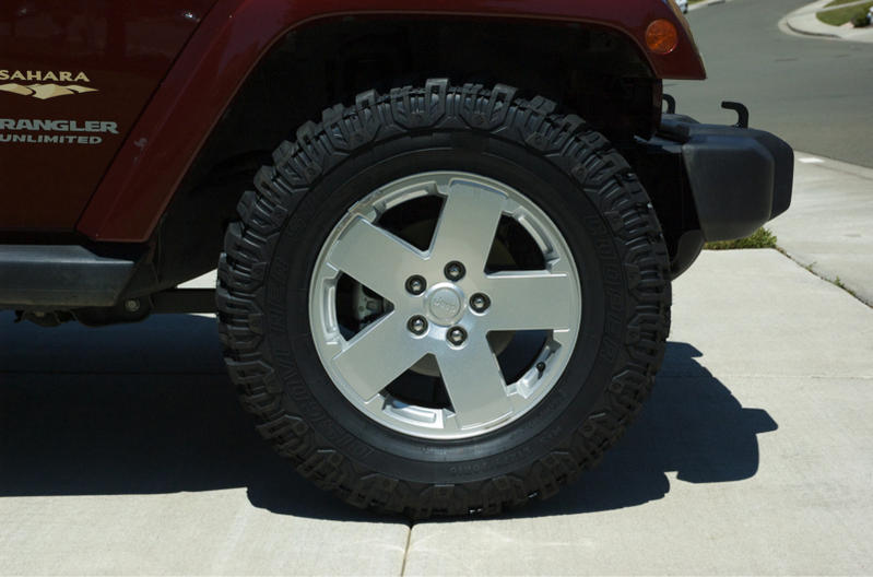

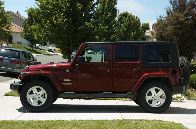

Cooper STT 275x70x18 skinny 33s & no lift. Made in the USA. Great overall tire. Some say it may chunk in rocks. Ran these for 3 years and a crazy 90,000 miles.
You may have to adjust your steer stops if the rubber rubs the lower control arms at full lock. No biggie, theres a write-up on how to do this. Or get Spidertrax 1.5" spacers that will place the wheels flush with your flares. Stance looks much better and increases stability in turns.
