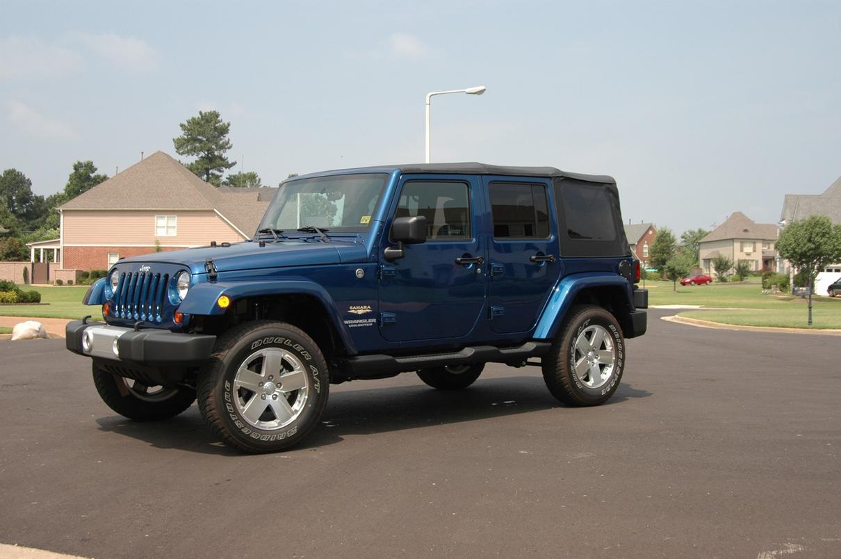

dcrna's Avatar
Joined: Jun 2009
Posts: 18
From: Germantown, TN
https://www.jk-forum.com/forums/atta...5&d=1246205249
Teraflex leveling kit installed
