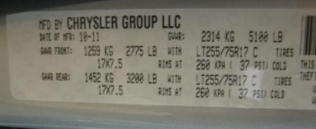

You can also find the max safe drivable weight posted on the inside of your driver door on a sticker. Here is a picture of mine below stating the Gross Vehical Weight Rateing (GVWR) is 5100. While it's not the "Gross Weight" but "Max Gross Weight" it will give you a ball park figure.
BASE OFF ABOVE WHAT MY 2DR RUBICON NEEDS
So in my case based off the door sticker (not technically "Gross Weight") with 15% added it would be 5865 minium winch capacity. The curb weight from the Jeep link above is 4104 lbs. So that method (1-1/2X to 2X) would give a minimum range of 6156-8208.
