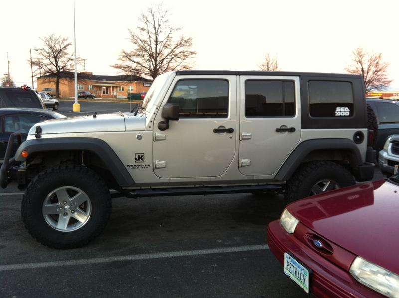

07 jku X. Finally lifted it and put some shoes on! Really excited about it. Went with the Zone Offroad 3" suspension w/ 35s. Looks awesome in my opinion!
Questions that crossed my mind today after the fact is: gearing... am I going to screw anything up by running stock X gearing w/ 35s on stock rubi wheels?
ESP... will having the dealer program computer for tire size make the esp warning go away on exit ramps and other sharp turns?
Any feedback is greatly appreciated!
