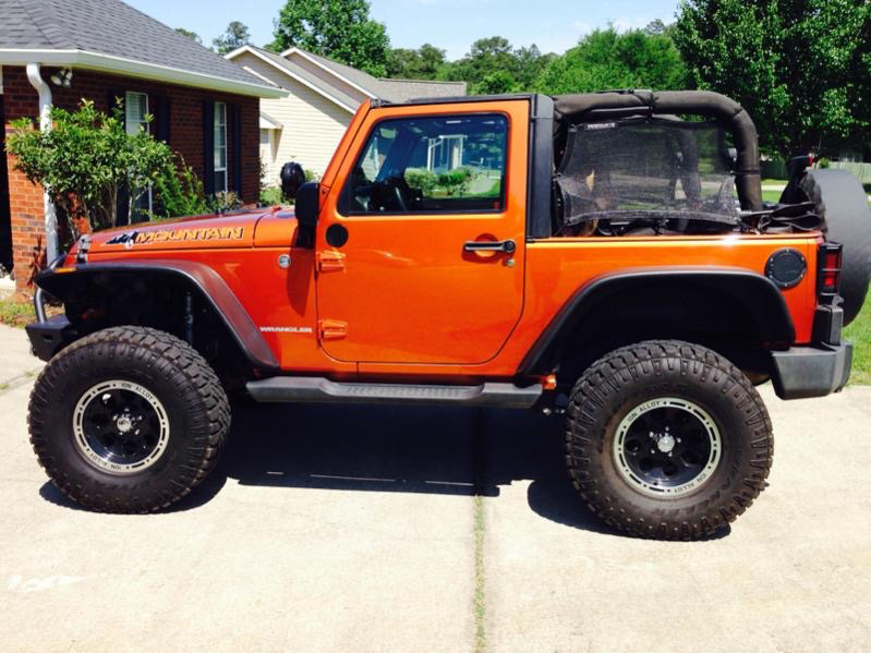

You'll get varying answers. I do mild wheeling..mud holes, water holes, dirt hills and trails in my area. Quite frankly that's all we have in Tallahassee. That being said.. I'm lifted 2.5, no re gear, stock dana 30 and zero problems.. I did replace my drive shafts, they gave up after 2 years of being lifted.
Many do truss and sleeve.. for DD I don't see the need. As far as a brake upgrade. I don't know anyone in my area that's done it. It stops as good as it ever did.
The best advice I've heard. If you're doing it for looks. 2.5 budget boost and 33s. It'll look great and maintain a good level of driveability. Either way..good luck on your quest.

2.5" lift and 35's
