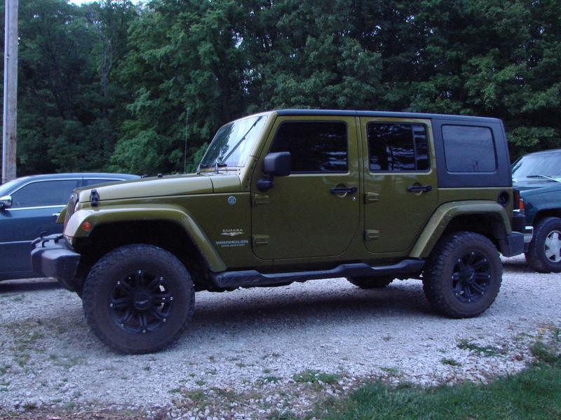

Hey,
I was wondering if someone could tell me what size of tires I can put on my 2007 Jeep Wrangler Sahara Unlimited, no lift. Currently have BF Goodrich Mud Terrain TA LT255/75/R17
Can I put these on without a lift: Nitto Mud Grappler 33X12.50R17/10 ??
Thanks

With flat flares, cut rear pinch seams, and 4.5 or 3.5 backspaced wheels, you can actually fit 35's on it. You'll want to add some bump stop, too, to keep those tires out of the fenders when you wheel. It's even possible to fit 37's if you want to do some fender cutting.
