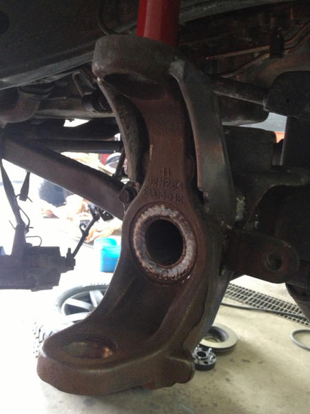

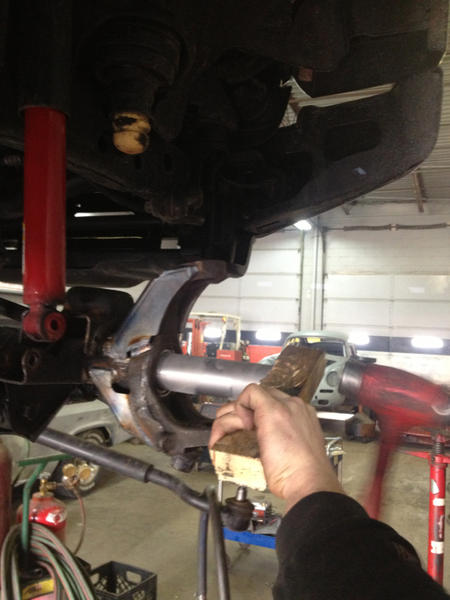

Mine went in with a dead blow and 2x4, super easy. Especially after deep freezing, welded the ends too.
