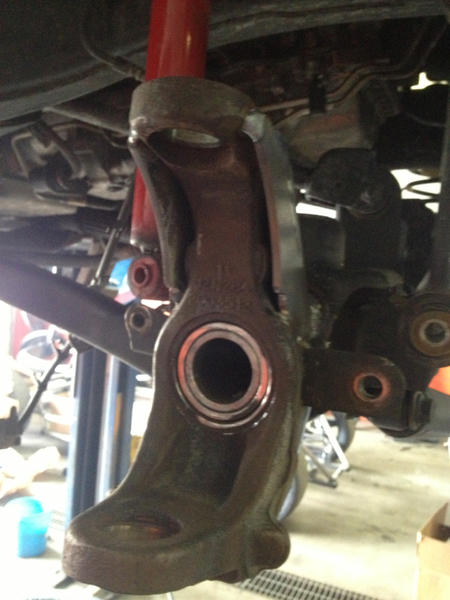

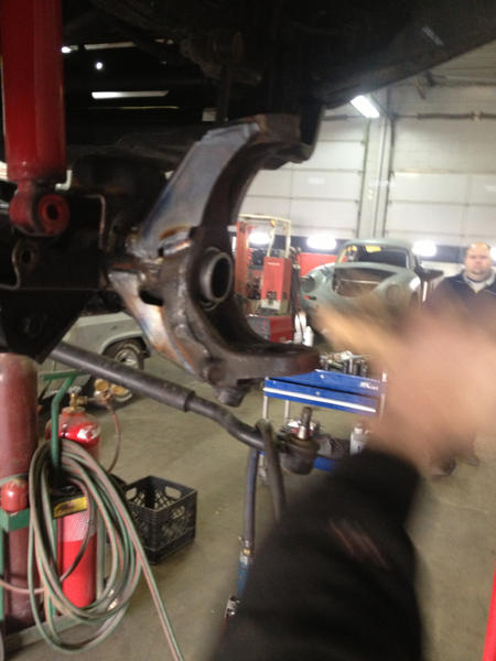

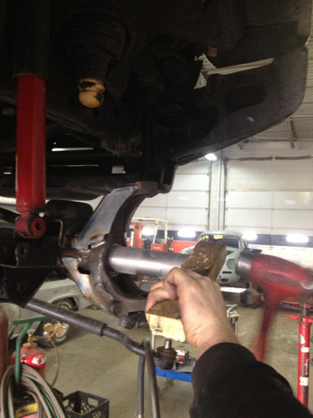

Wow, dry ice, super amounts of cleaning, honing, grease...you do have everything covered!
I simply stuck mine in my home freezer and after a quick axle cleaning with a rag pounded them in. The grit and grim help the interference fit in my opinion lol.
Good luck!
