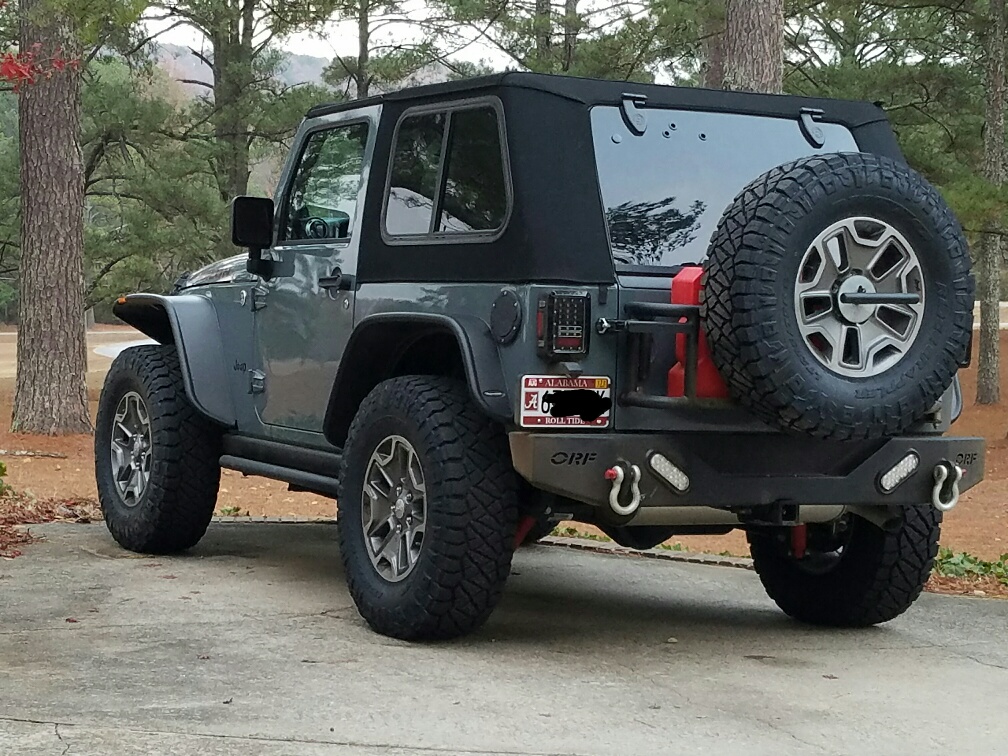

I think I've read all the posts on several sites aboutsizing tires. There seem to be manyvariables so that each instance is almost unique.Front bumper type, flare type/modifications,lifts etc.Just wanted to share thisexperience - it may help someone else with the same setup.
Specifics:
Objectives: I wanted to run the largestpossible diameter tire with no lift.The tires had to stay under standard width fender flares (personalpreference, not mandated by local restrictions).I wanted to maintain the lowest center ofgravity possible, with the best clearance.The jeep will be driven by inexperienced off roaders, so I wanted tomaintain near stock ride characteristics and quality.
Mounting observations.
Front: First we triedinstalling a front tire without the spacers.We mounted a tire and installed on driver's side front without the spacers.We lowered the jeep and tested for steeringclearance.At full right turn, the frontinside of the left tire just barely rubbed the sway bar – since we have zerotolerance for any contact, we installed the spacers.There were no other "steering limit"clearance issues after the spacers were installed.
Rear: While hanging from the rack, the rear axle swingsforward and the front of the new tire is actually in front of the"RubiRail", but when lowered on level ground, there is about7/8" of clearance between the tire and the rail. Even at full “stuff”, as reported later inthis topic, there is no interference with the “rubirail”.
Mounting conclusions: This particular tire on this Jeep setup will require spacers toeliminate rubbing at full lock steer – otherwise in on-road use I imagine it’dbe fine.The tires do extend further forward in thefront, so if I had a full length front bumper – it might rub – I have no way ofknowing since the short bumper came before the tires.I will say this: the tire takes full advantage of the flatfender’s extra clearance.
On the road: Norubbing issues.The tires look greatand even with the spacers, all of the rear tire and all but maybe one-quarterinch of the front tire stays neatly tucked under the standard width Bushwhackerfender flares.We just drove acouple-hundred miles back and forth to the Iron Bowl on the original BFG mudterrains (we have 3600 miles on the Jeep) a couple weekends ago.Subjectively speaking, the new Nitto tiresare significantly quieter and ride better to my seat of the pants.At interstate speeds+, I imagine wind noisearound the soft top becomes the bigger noise factor and negates any noisebenefit, but running back and forth to town at 55 mph or less, I can say Iprefer these tires.And, if I never left the road, I’d probablybe okay without any bump stop or lift modifications.

- 14 Jeep Rubicon 2 door.
- Completely stock suspension.
- The Jeep has added weight in front and back fromAftermarket Fr and Rr Bumpers, winch, Aftermarket tire carrier/jerry cans. The Front bumper is mid length, so steeringtire interference from the bumper will not likely be an issue.
- Bushwhacker flat fenders.
- Nitto Ridge Grappler 285-75R 17 on OEM RubiconWheels – these tires are approved for 7.5” rims. We bought load range “C”, rather than the10-ply version. The tires are marked onthe sidewall as OD = 34”, OW = 11.5” – that’s within horseshoe range from anyactual measurements I could report within this site’s directives..
- Spydertrax 1.5" spacers.
- Use – Its’ our extra car, so 10K miles per yearon the road. Recreationally, exploringTimberland – logging roads, fire lanes. Also jeep trails on the National forest. Hunting club transportation and running aroundthe farm. We live in the Southern Appalachians, so someof the fire lanes involve steep climbs and descents on aged and washed out firelanes.

I bought the 2014 Jeep with just over 3000 miles about a month ago. The previous owner made a lot of great additions, but never drove it, and finally sold it because of non-use. I replaced the extended fender flares and changed to the Rigid Ind. Duallys. The photos include an "As Purchased", Before and After Tires
