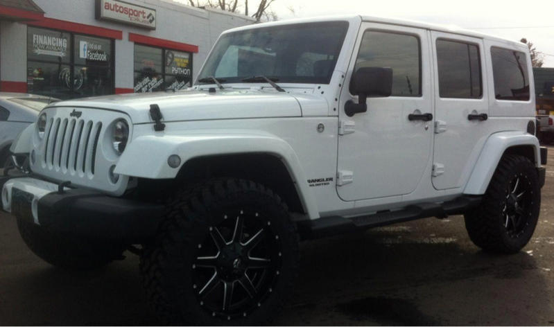

Old Jan 10, 2013 | 01:16 PM
lisn2me's Avatar
Posts: 20
From: Cleveland, Oh
Well at least it looks good.
