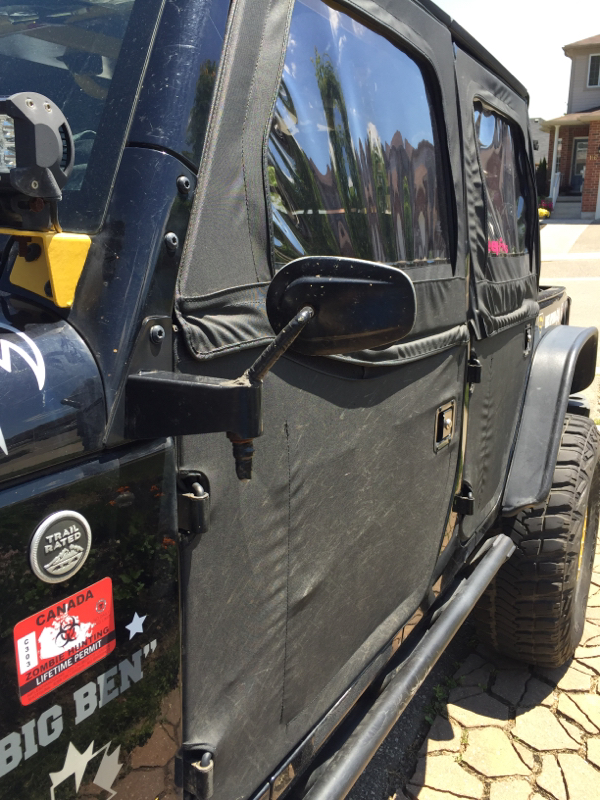

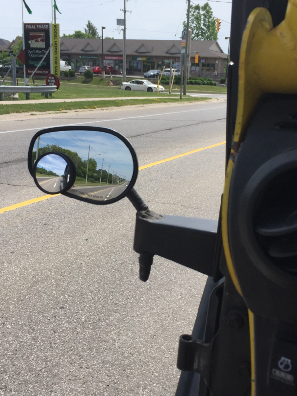

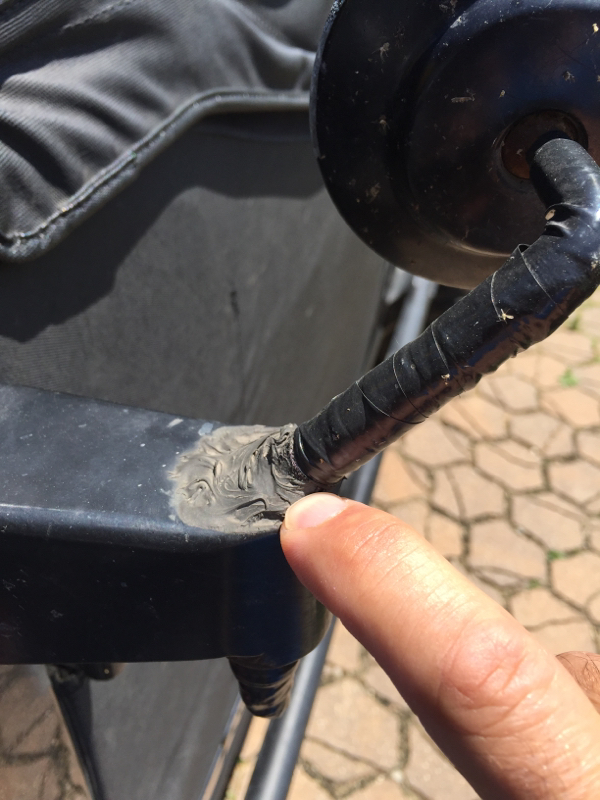

I use the Harley Davidson bike mirrors all year round they don't move ...... All I needed was a few extra washers to fill the gap in the arm where it's not threaded ..... Then a nut nice and tight at the bottom(some silicone to fill the space) Mind you I use the rugged ridge relocation brackets so I can keep the mirrors on all year round and not have to keep removing the mirrors from the door hinge
