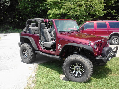

I've run that way for the better part of 18 months now. Just got to remember to clean under the hood and take it easy through deep water. I'll put them back in when I get over my lazy spell.

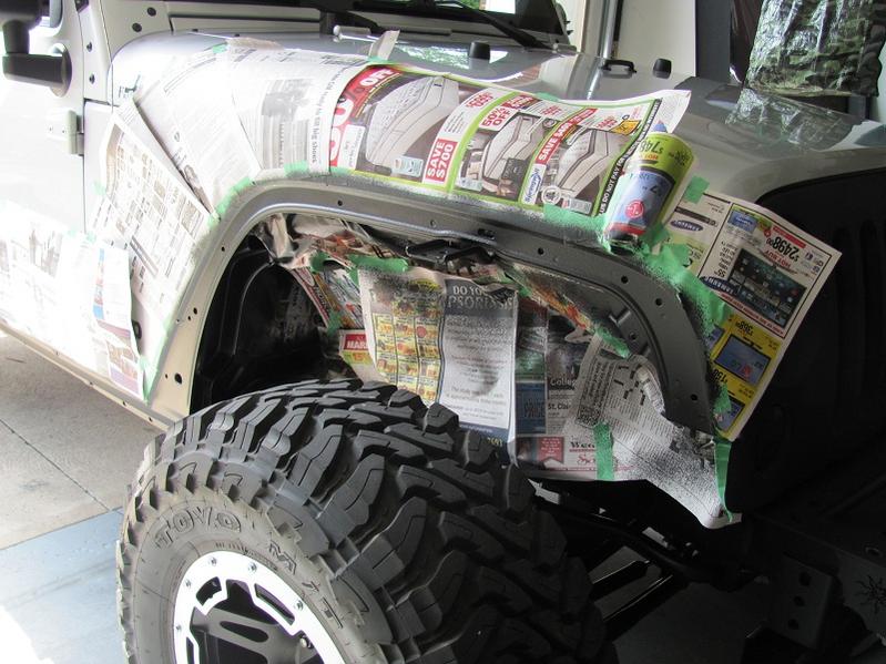

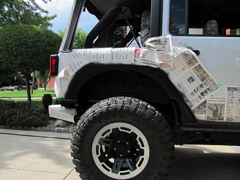

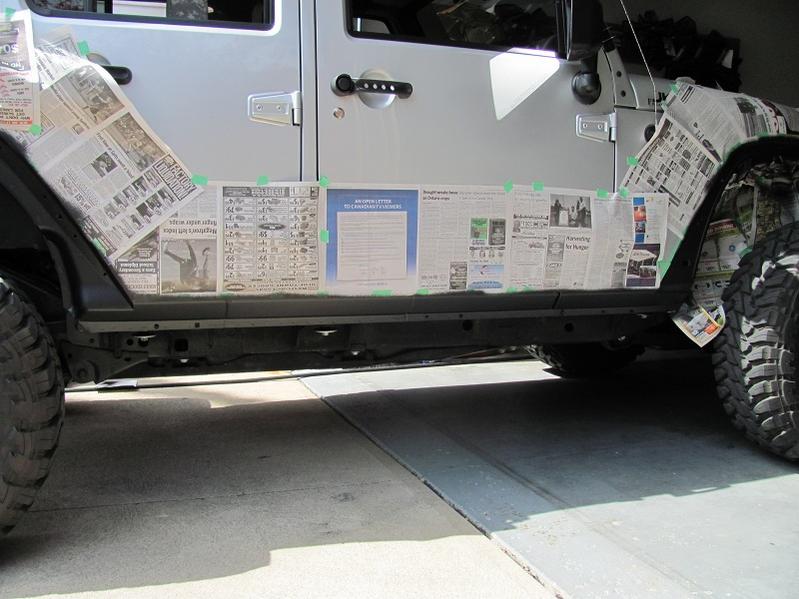

No need for liners....just spray a good coat of rubberized rockerguard in the wheel wells....better than having crap trapped behind the plastic liners imo...
