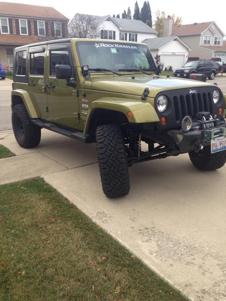

Can anyone tell me if this is normal? This is what my wheels look like at turn.

It's the same on the other tire if I turn them the other direction.

The axis the knuckle pivots on is tilted back, (positive caster). That makes the tire lean when turned as shown in your picture.
It's completely normal.

Okay cool thanks. I had never actually noticed this before so I was like WTF? Lol. I knew that the tires should normally be slightly angled because of the knuckles. Just never seen this dramatic of an effect. Must be the larger tires. Just double checking. Thanks!
