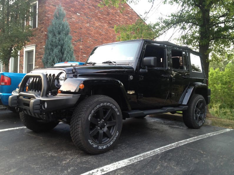

I have the Teraflex 1.5" JK Leveling Kit and Spidertrax 1.5" wheel spacers with stock wheels and tires. If I could do it again I would go with the Teraflex Performance Leveling Kit (coils) over the pucks, my rake returned once I installed an AEV Performance front bumper.
