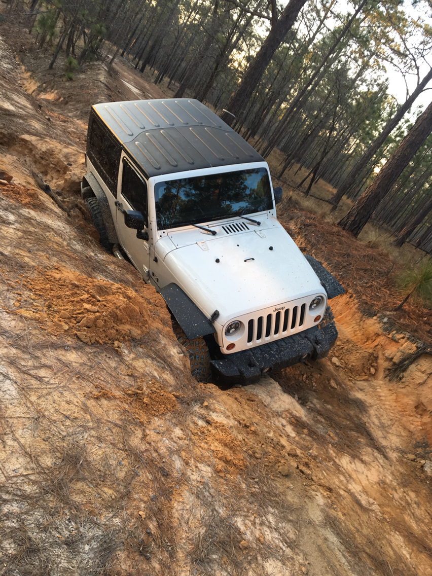

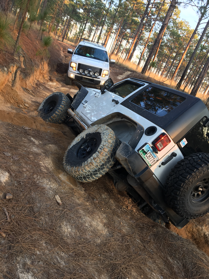

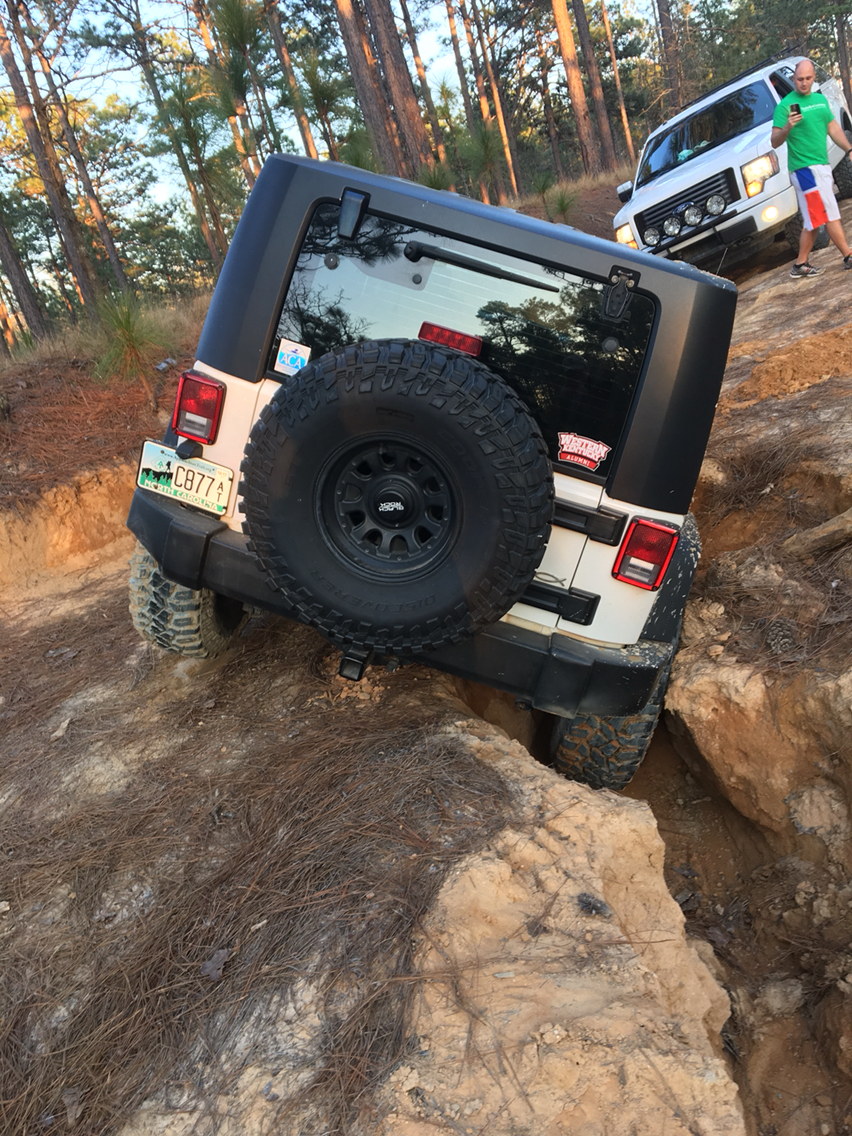

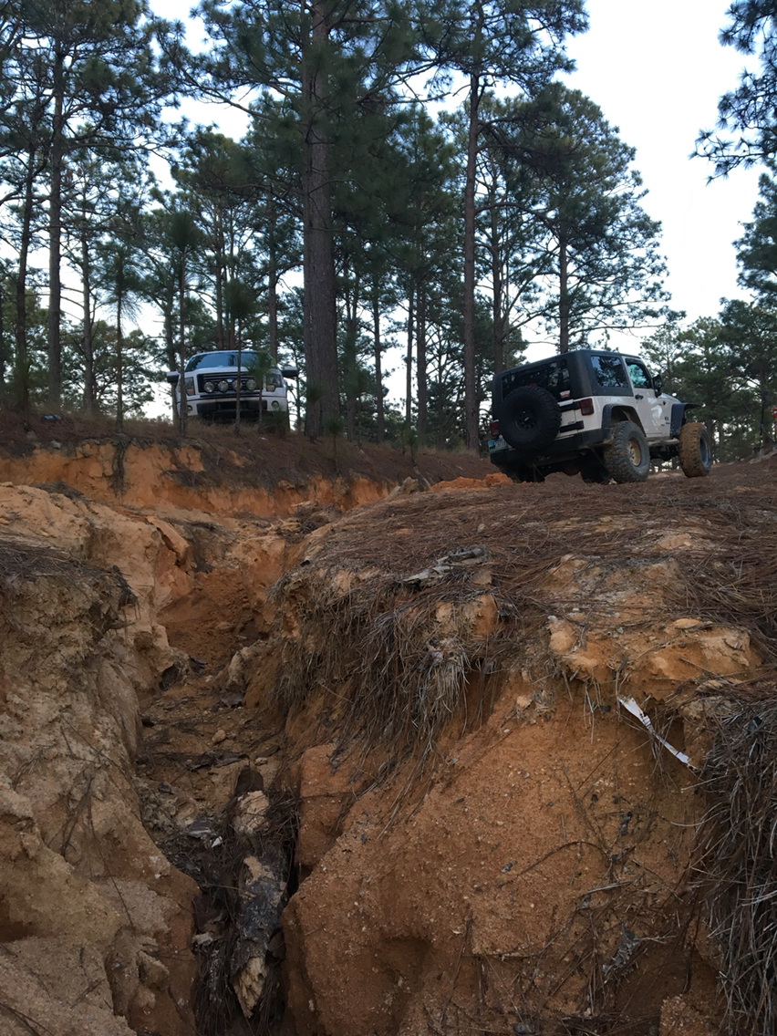

Well got back from my 3 weeks of training for work. The Jeep got the BDS lift and cooper 35s under her. So naturally I had to take it out and test it. Took it out with the GF on Friday nothing too crazy. But when I had it all to myself I went out exploring some new trails. And with all the rain we had here we had some crazy washouts. Well the JK found one about 2.5' deep that I didn't see when going up the trail. Got her stuck really well, had to call my roommate to bring my F150 to get me out. But now the steering feels loose and when I turn left it wants to pull and wobble. I have no clue what's causing this but I'll get under it tomorrow. Also when I was trying to get out I heard a loud snap from the front axel and some clicking when the drivers side front tire is under load and in 4wd. If anyone has any ideas please let me know. I'm sure it will be back in the shop to get fixed.
Enjoy the pics

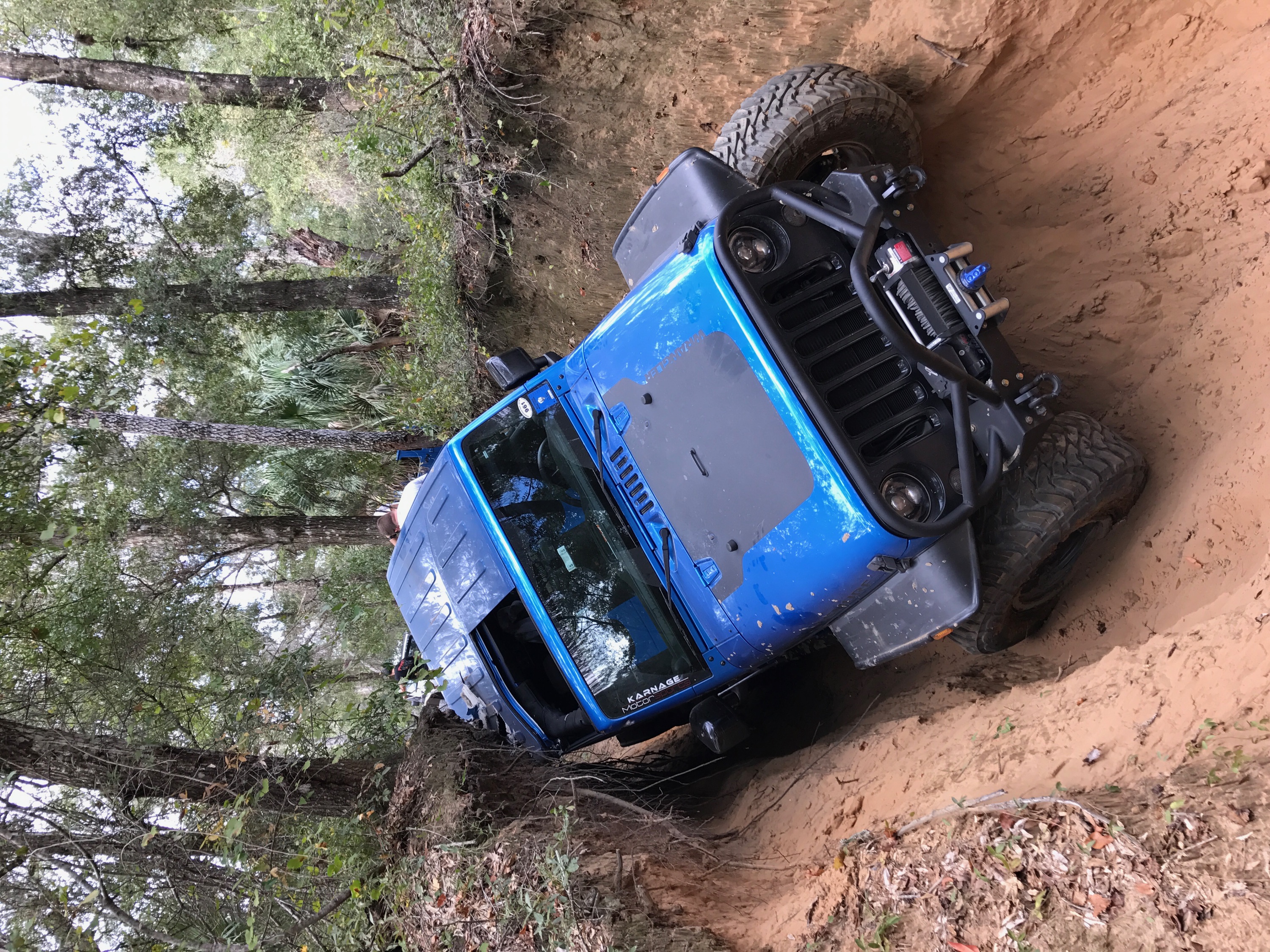

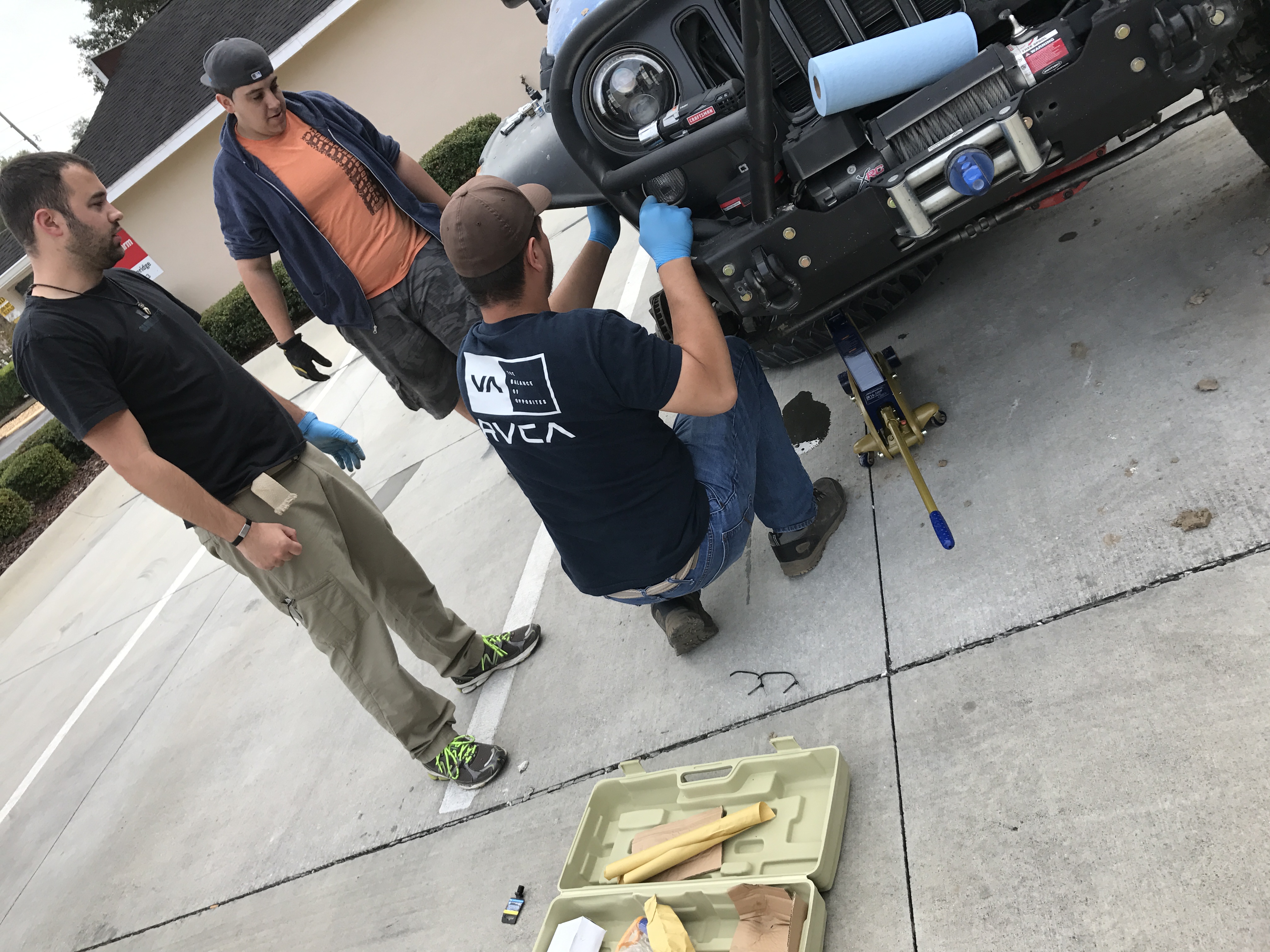

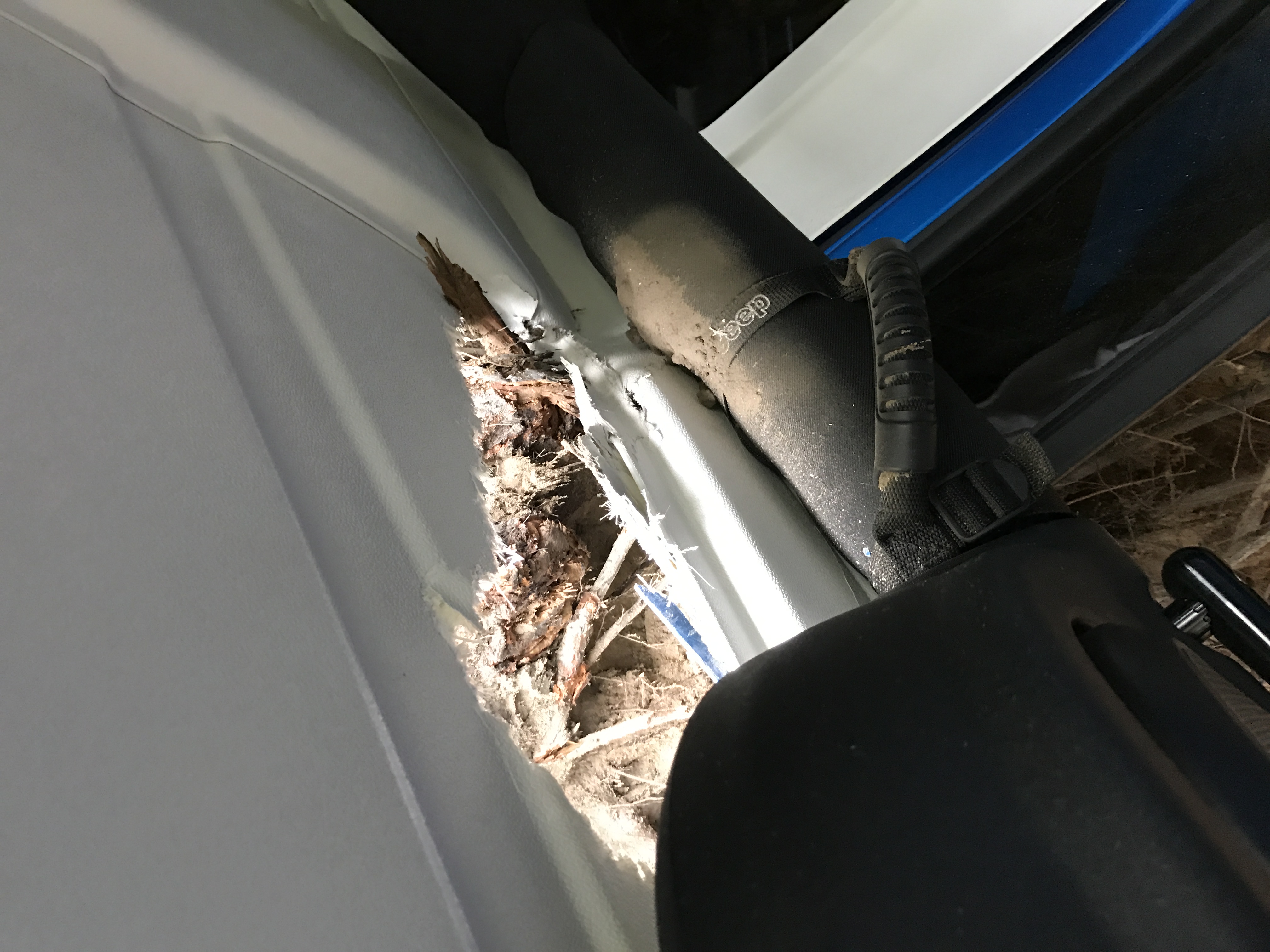

Mine was a smidge different/worse. I knew I broke something big time. As soon as I heard the pop, I was oozing diff fluid. All in all, $7k in body repair and a new Tera 44. And indeed, as Shutterbug mentioned, I was wheeling with a group and we took a break. I wanted to "explore".
We pulled the diff cover and r&p looked good. Filled it up and drove back to camp. Still leaking and making a noise, we pulled the shafts and found the passenger shaft broken. It wasn't until home and pulling the locker to see it had cracker. Tie rod was bent. It was a mess.
Good luck...yours sounds easier than mine!

First off....how the heck did you not see that rut??? LOL. I can giggle cuz I've done similar...cept mine was while backing up. This right here is the TRUTH -
