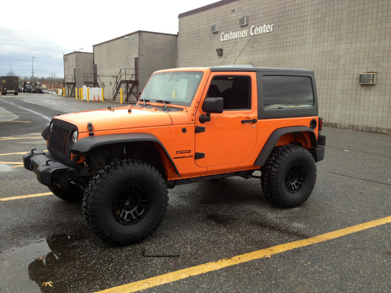

If you had a 2012 I'd say go for it but I can't speak for the 3.8 ( mine was stock). I just put 35x12.5x15 km2's on my 2012 with 3.21s and manual. It's fine around town, not TOO bad on highway, especially if my commute were flat. You will definitely lose 6th probably. I tach 1750-1800 rpms in 6th at 65mph, 5th is like 2100, which is fine. On flat road doing 68+ I can use 6th.
Gas mileage goin to work (all highway over 2 mountains, 28 miles) has gone from 19-22 to 16-17.

Ps stock tire/ wheel combo is 60lbs each with 17" wheels. My mb tko and 35" km2's are 83.5 lbs each according to UPS

What size lift are you running? I to have a 2012 and want to run 35's
