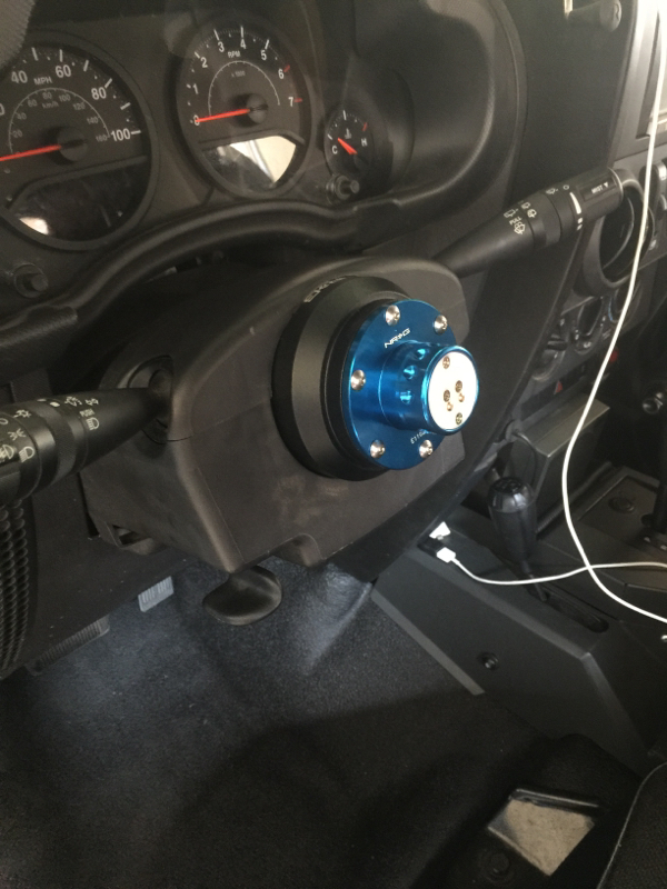

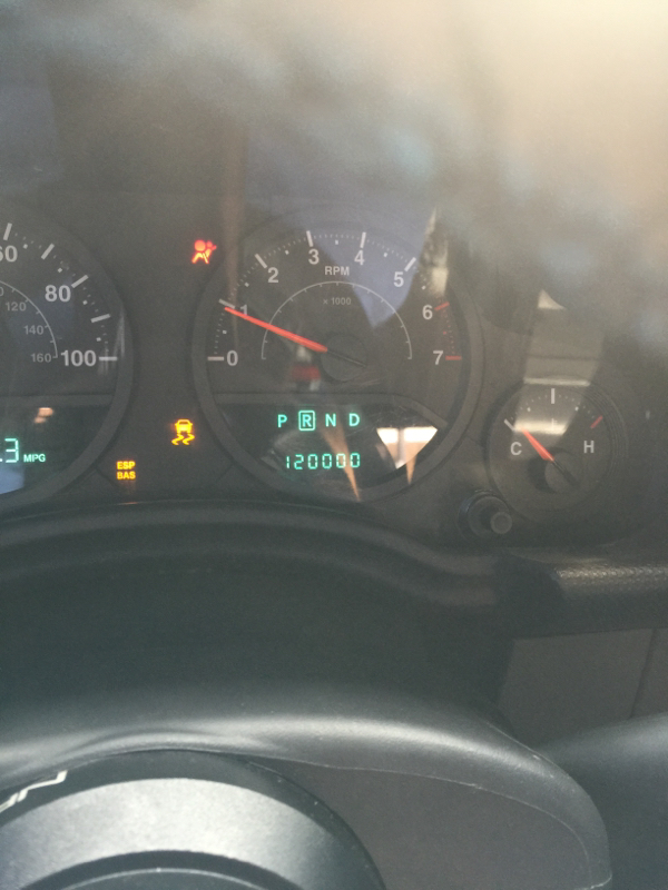

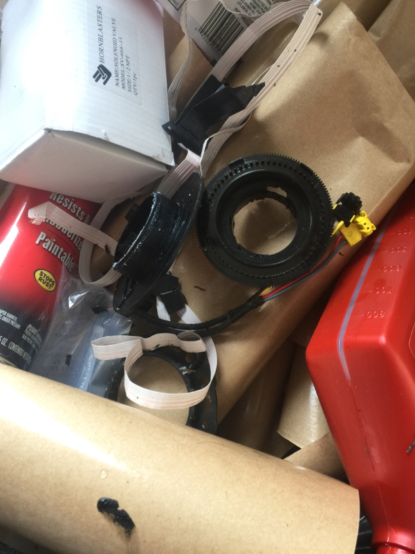

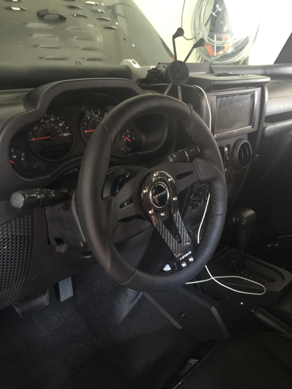

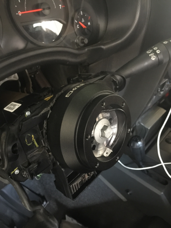

Warning!!! Don't do this if you like all the fancy safety shit on your JK! My Jeep is becoming more & more of a dedicated trail rig so I decided to install a new steering wheel. I did some research but couldn't find much. So experimented & found a NRG hub adapter that would fit the JK's. I thought that I would just be able to remove the cloak spring but unfortunately Jeep decided to build the Headlight, blinker, & windshield wiper controls into the Cloak Spring so removing it completely wasn't a option. I had to hack it up In order to get the hub adapter on which was kinda Fun. Anyways, it's a pretty straight forward install and I love the way it turned out. The downside is you won't have a horn, air bag, cruise control or any electronic traction controls. Lol Here's a couple of pics. Click image for larger version

My clockspring took a shit yesterday. I may just do this also. Is your airbag light on? What part number on the adapter? I want one i can pull the wheel off as i sit very close and most likely when i go bucket seats they will not slide front to back

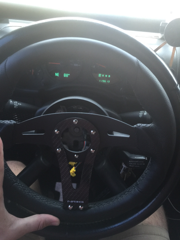

You will have a glowing dash after the install! Lol Here's the part # for the short Hub. NRG SRK-170H. I used a 2.0 quick release but I think the 2.5 would've been better for easy on off action. The wheel is pretty small at 12.6" & at first it felt weird but I quickly got use to it & love the sportier feel.

The 2.0 quick release.

The 320mm wheel compared to a stock JK

Where a Clock Spring belongs! Lol Click image for larger version
