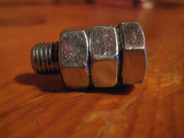

get a 1 inch 17mm bolt two 17mm nuts and put both nuts on one nut locks the other in place no cutting grinding done so it will look like this >
then just use a adjustable wrench or open end on the middle nut easy beans hope u like this idea works very easy $1.29
