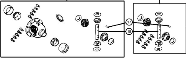

Maybe it's #17...
I think it's called a "rolling pin"

I have been searching high and low for a diagram of the carrier assy online. Thanks so much. I don't think it's no. 17 as I believe 17 is:
that shiny pin in the hole in the carrier but I'd like to verify. Do you have a PN for it?

17 is part 01791563 - PIN, Differential Shaft
