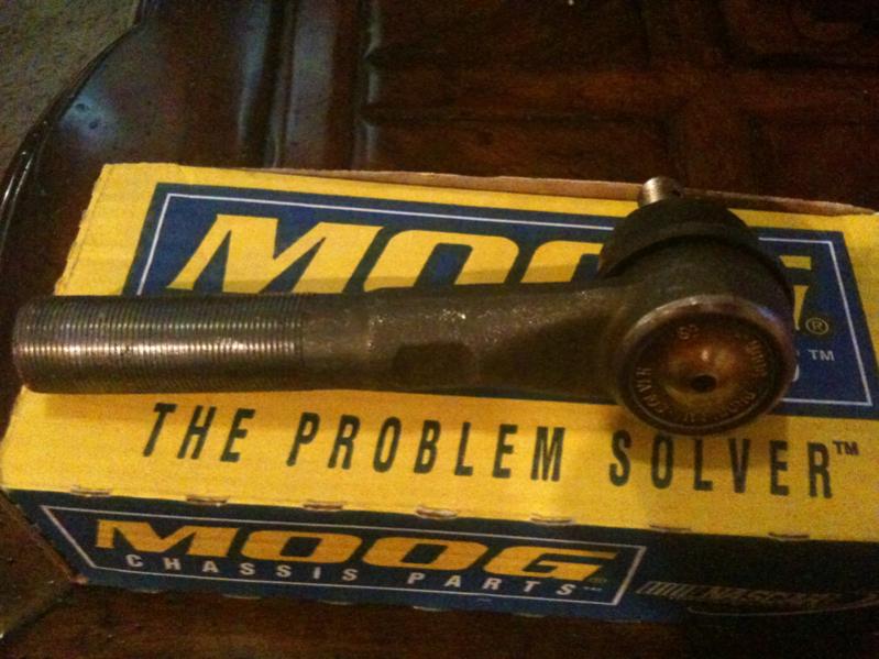

I bought the Moog draglink end#ES3624 for $28. It fits the stock drag link and is originally for Dodge Heavy duty trucks from around 2003. It's grease-able also. If this is designed for stock drag link, it should fit your RK Tie Rod ends if they use stock drag link ends

How long have you had these on? Any issues? Are they visibly more beefy than OEM? For $28 that's a bargain and greasable to boot. I'll have to look into these. How did you know these would fit our JK's?

Actually, I am putting it on next week. I bought the Currie Tie Rod, but wanted to strengthen my drag link without replacing it since I learned plastic was part of the inside of the end. I did some searches and learned this Moog part was compatible for the OEM drag link and RK tie rods. I will let you know the outcome. Sad, how Chrysler didn't Just use A Dodge 3/4 ton truck part for the the Jeep.

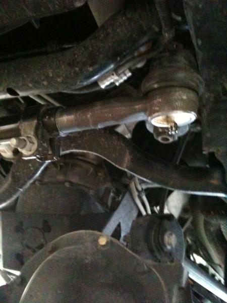

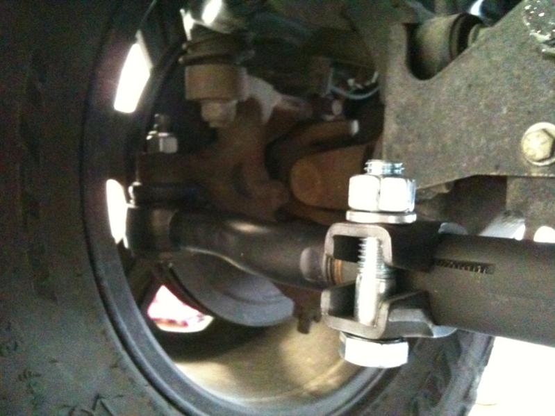

Well, I got both on. The Currie Tie Rod is a beast! It must weigh 45 lbs compared to 5 lbs to the stock rod. The Moog drag link end fit perfectly on the stock end. 1st impression; very tight and stable and bumps do not translate much to the steering wheel!
Sweet! This is in my future now. Thanks for posting.
