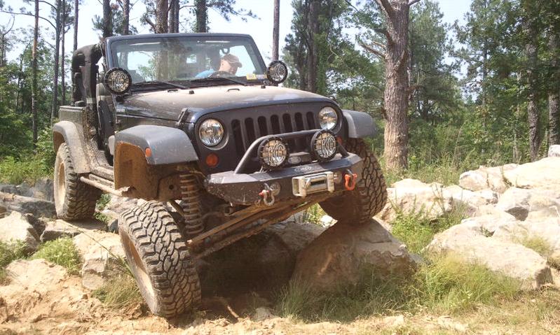

I was hoping to discuss a few topics and get a little bit of perspective from others.
I'll start off by telling you my setup and what I would 'like' to do next. I have a 2 Dr with an RE 4.5 LA kit intended for a 4 Dr which supposedly netted me an extra inch. Measured up next to my friend with a FT 4 in we sit about the same, however I have bumpers and a winch, so I figure I lost about an inch there which is all fine. I am currently on Pro Comp Xterrains 315/70R17, which should measure out to 34.4 but actually come in just shy of 34.

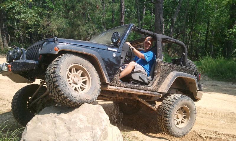

The terrain I wheel is what we have out in Tennessee, trails, dirt, plenty of off camber situations, steep climbs and descents that make me pretty nervous. I haven't come across something I couldn't make it up or over... yet. I stuff perfect and droop just a little too far. Springs unseat both front and rear, but that's a different story.
I want to move up to 37's. I love how they look, but I am not sure I should. I recently went out with a friend that has a stock Rubicon and was blown away by the places he went. Other than over a bit of rock that would have made clearance an issue, there wasn't anywhere I went he couldn't. A few places were easier for him because he wasn't worried about flopping where I was. Should I have been? I don't know.
All of this got me to thinking, if I go any bigger with my tires, it seems that I would be losing out in a couple of places. I believe under full stuff, even after trimming I would be limiting myself on up-travel. I don't know by how much, I've never been on an RTI ramp. I would have to run it twice, new and old, to have quantifiable, empirical evidence, which I am not willing to do. The other issue is how much more prone to a rollover I would be. Once again, I don't know by how much my critical angle would change. I know I could negate this by removing lift, but that would limit my up travel even more. Like I said, I am just trying to gain perspective on this, make sure I am thinking about this correctly.
Any insight anyone has, or possibly even reassurance that the change experienced would be negligible, would be great.

It's more that I'm worried about rolling over while off camber. I've been sideways something to the tune of 30 degrees. I was way out of my comfort zone even though I apparently looked fine. I just don't want to get a taller tire and then find out that where I was before is too far now.
