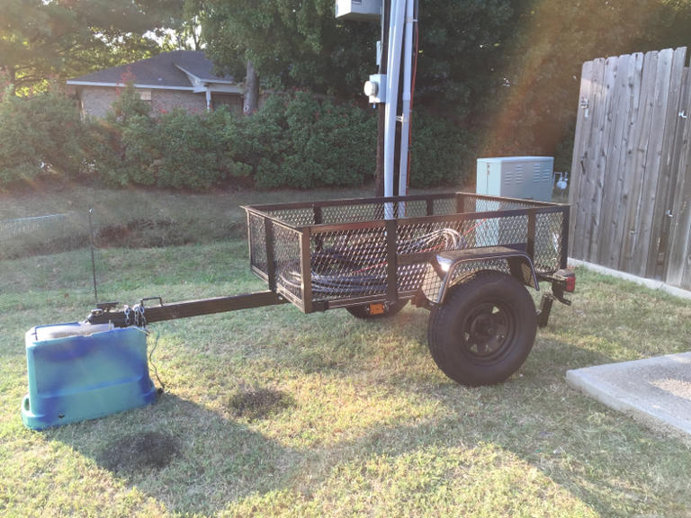

Originally Posted by HogHoden
Westtexasjku,
Just a quick thanks for the inspiration
I had some time this weekend to finally get started on modding my trailer. Started with the same base as you and so far I have:
1) Extended tongue (also lengthened it to run all the way back to the axle)
2) Installed wider axle
3) Cut off fenders
4) Mounted wheel adapters
5) Mounted Rubi Take-offs
Still have a lot of work to do, but I like how it's coming along. I got enough done that it's usable as a utility trailer again.
Attachment 492106
I stayed with a 2000lb axle because I know I won't every put that much weight in it and wheel adapters fit over the hubs and dust caps. I also kept the stock springs, but may replace those. They are pretty noisy when the trailer is empty due to the 'slip' design. I will probably add in a couple of struts off the front to support a tongue box and am looking for options for replacing the expanded metal.
I'm also going to put a receiver hitch on the back and figure out how to rig up a canoe/kayak rack on it as well. Possibly add a dry box (maybe on the tongue) and add a battery and some LED lights. Lots of ideas right now...

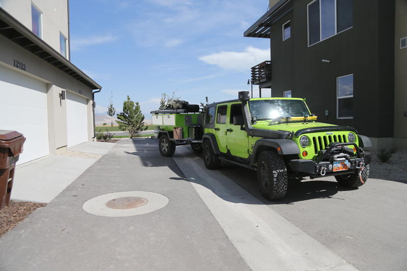

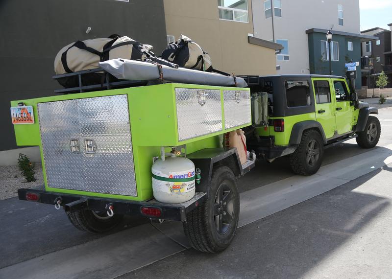

ID:	580900Click image for larger version
ID:	580901Here are a couple of shots of my offroad build. It is a copy of one that was covered in Expedition Portal
called the "Small Garage Build". It has a 3500# axle with e brakes, a slide out for an ARB fridge and ARB awning. The pictures were taken before an 11000 mile trip this summer to Canada and Alaska.
