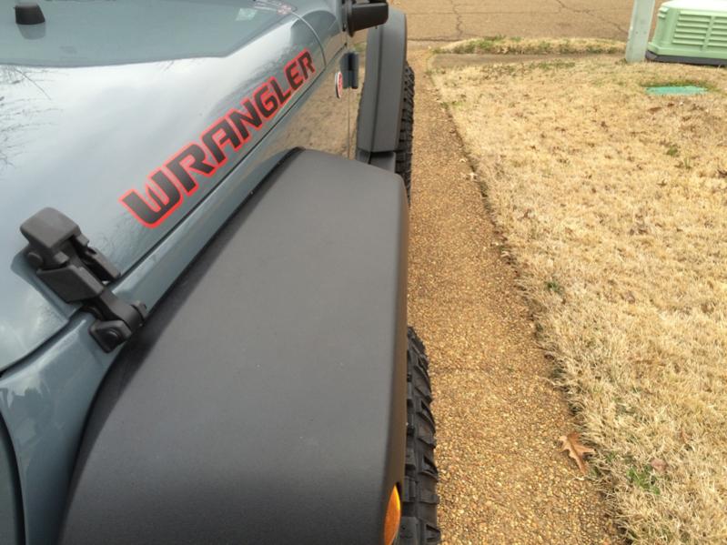

-6 offset, 285/75R16 Level 8. No rubbing here. Pic is before any lift

Mine sit out a lot farther. My wheels are 8.5" wide. I think -6 is like is 4.25 or 4.5" backspacing.
