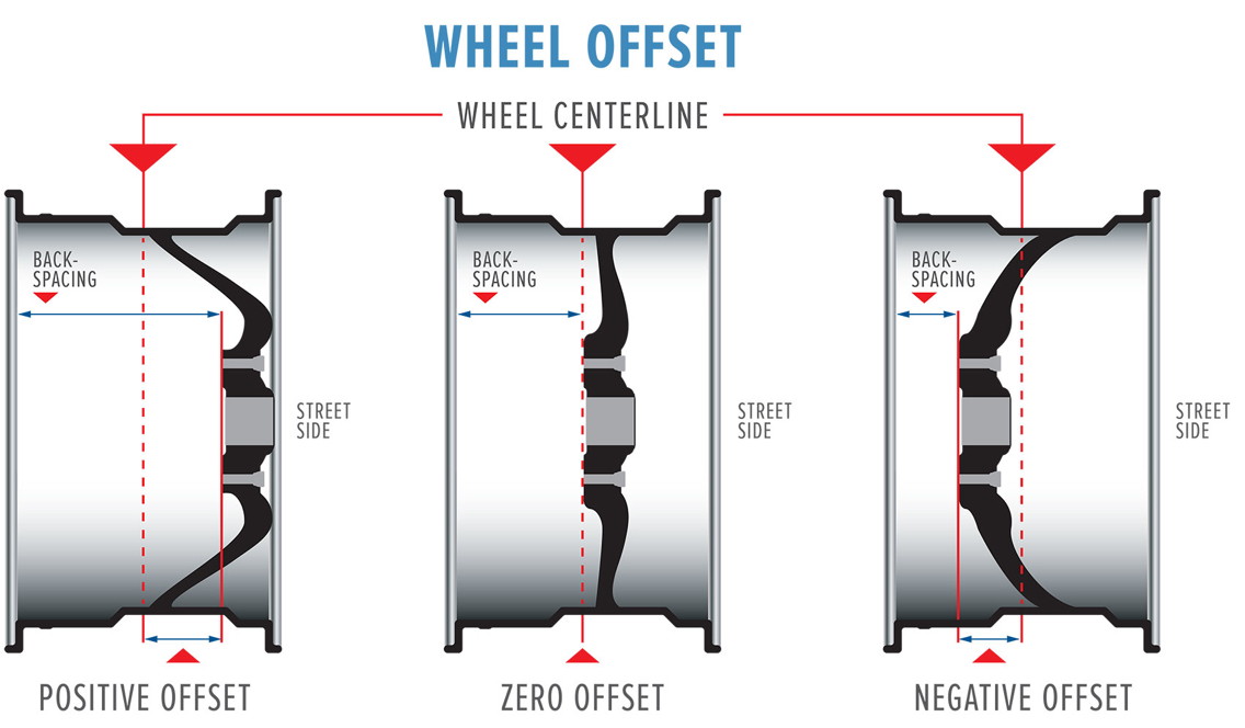

To push the tires out you'll want a negative offset. You want to know the width of your current tire vs your new tire and then you can figure out how much offset you need. Here's a link to a website I like to use for wheel and tire stuff and I visual to explain offset.
https://tiresize.com/wheel-offset-calculator/

Stock backspace is 6.25" which is +51mm offset

Positive moves the tires into the wheel wells. Negative moves them out. But, where they start and end up varies by the specific width of the rims you are looking at. Easier just to convert any offset number to backspace, then subtract from 6.25 (stock) to see appx how far out the rims will move. A 4.50" backspace moves the tire out appx 1.75". (6.25 - 4.50 = 1.75) Plus/minus any difference in rim and/or tire width.
For 35x12.50 tires, the typical recommendation is 4.5" backspace.
4.5 bs for 7" wide = +12 offset
4.5 bs for 8" wide = 0 offset
4.5 bs for 10" wide = -25 offset
Also remember that there can be a significant difference in both height and width between tire mfg's - for the same stated size. So that 4.50 isn't a rule, just a recommendation. There could easily be an actual 1-1.5" height/width difference between the tires you mount and what you saw someone post about. Clear as mud, huh...
