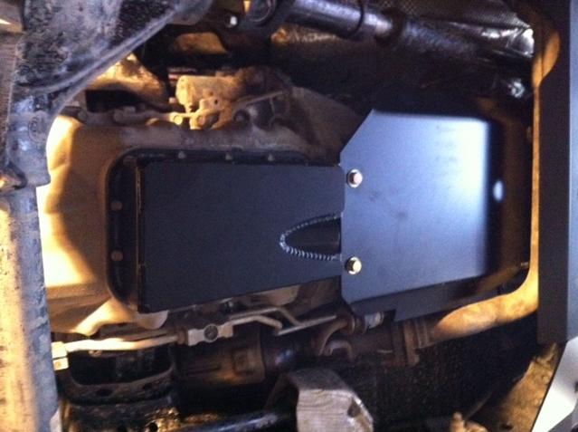

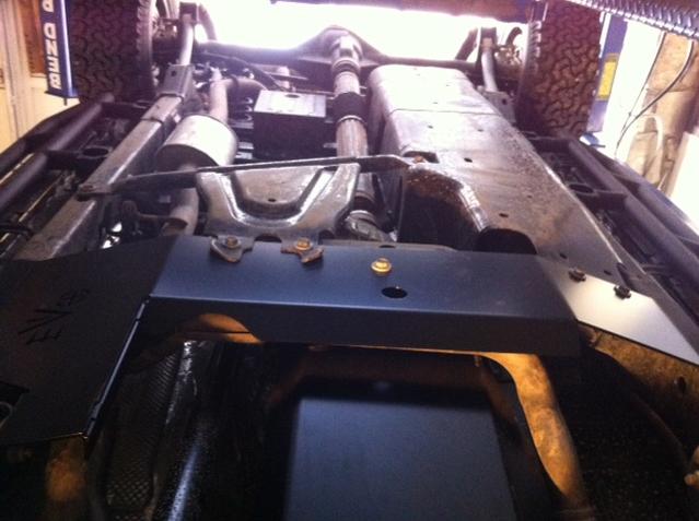

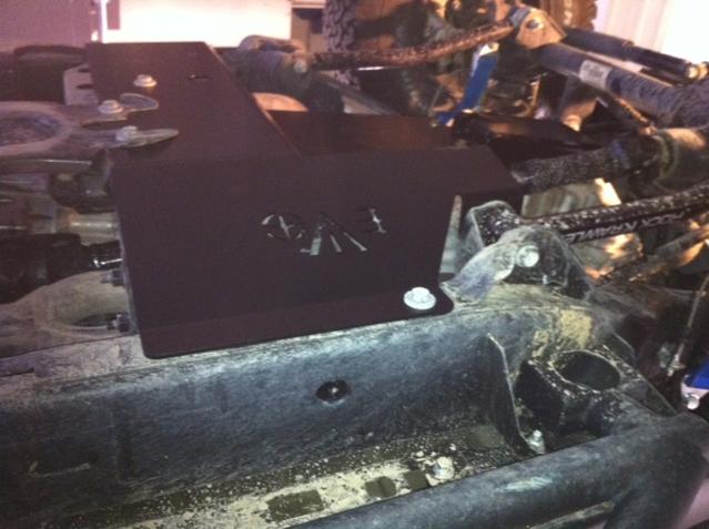

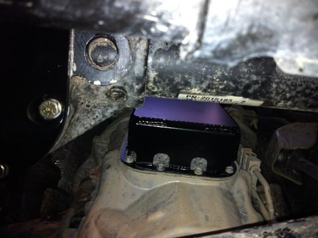

One more vote for the Evo 3 piece system, that's what I have. For $400, it's a really good deal. For that price, you're getting a 3 piece system while other manufacturers you can barely get the oil pan skid for that.
Originally Posted by Freyja
Oil pan skid and don't forget that pesky evap canister skid on the 07-11. As well.
Not necessary on the 2012, it comes with an evap skid. I do recommend moving it to the left a little bit or relocating it. My last wheeling trip my rear DS boot got torn, looks like it hit the evap skid.
ID:	307305   Click image for larger version
ID:	307307   Click image for larger version
ID:	307308   Click image for larger version
