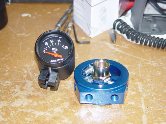

I installed the adapter and sending unit a while ago and I am satisfied.
Oil filter adapter plate size 3/4 UNF-16 part # 3/4UNF-16 purchased from Prosport Performance at a cost of $38.99 : Z series oil pressure gauge, 2- 1/16electrical ,100 PSI / Part # 105-2634 from JEGS at a cost of $59.99. It was simple to install, I am going to try to include pictures.

thank you for the information.
i am guessing there is no way to attach it without and adapter??

Install a T fitting under the oil pressure switch so you can have an oil pressure sending unit and still have the idiot light switch.
The oil pressure switch is located on the right side of the timing chain cover, above the oil filter.
